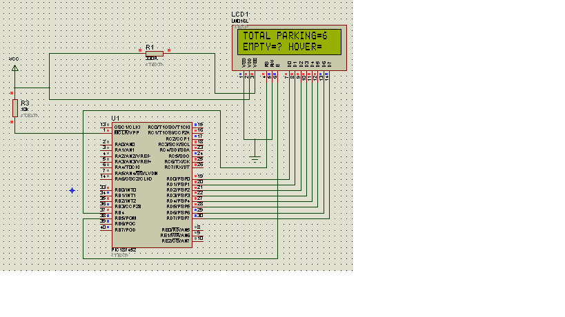

Please see the photo below. I put the compiled code (hex file) into Proteus simulation. It does running normal.

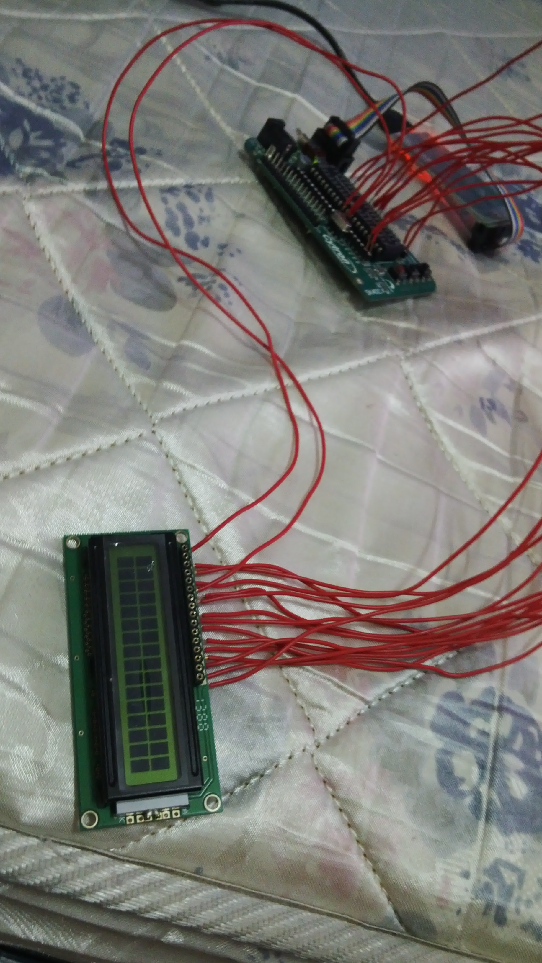

But when I put the code inside my PIC18F4550 connected to all 16 pins of the LCD (TGK model bought from Cytron), there was just a block of black display appeared. I have check all the solder points, there are no short circuit between all 16 pins.
Simulation OK, but real hardware NOT OK.
How????
real hardware result

Here is what I got from simulation in Proteus...

Postby robosang » Sun Sep 29, 2013 9:55 pm
I think the contrast is not adjusted correct, looking at 2 rows of black box on LCD.
Re: LCD does not show up the characters
Postby mohdismiaswaly » Thu Oct 03, 2013 12:18 am
You mean the connection of pin 15 and 16 on the lcd?
So I need to connect variable resistor in series to that pin?
mohdismiaswaly
Posts: 39
Joined: Mon Nov 05, 2012 2:51 pm
Postby yonghui » Fri Oct 04, 2013 10:46 am
contrast is the vee pin. adjust the votalge value by changing resistor value.
