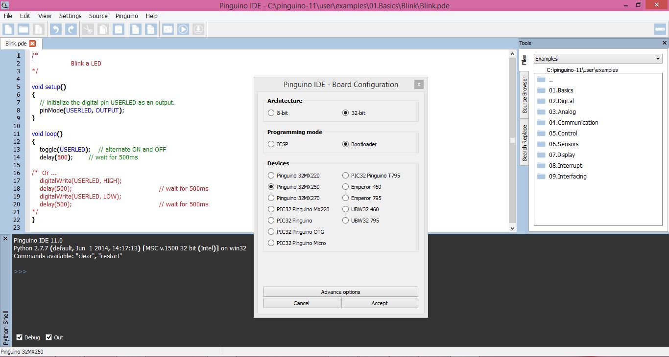

Then I tried inserting the vendor ID and Product ID but to no avail. I tried to upload the program into the microcontroller after compiling it. My settings for the IDE are as instructed in the SK1632 user's manual.
I have followed the user's manual and the online tutorial carefully but was unable to identify the problem here.
Unlike Arduino that pops-up in Device Manager under Port (COM), this board goes undetected. :?

In order for you to upload program, make sure the PIC is in bootloader mode. Step to bootloader mode can be refer in user manual in page 18 since we have update SK1632 user manual and you can refer to link here.
