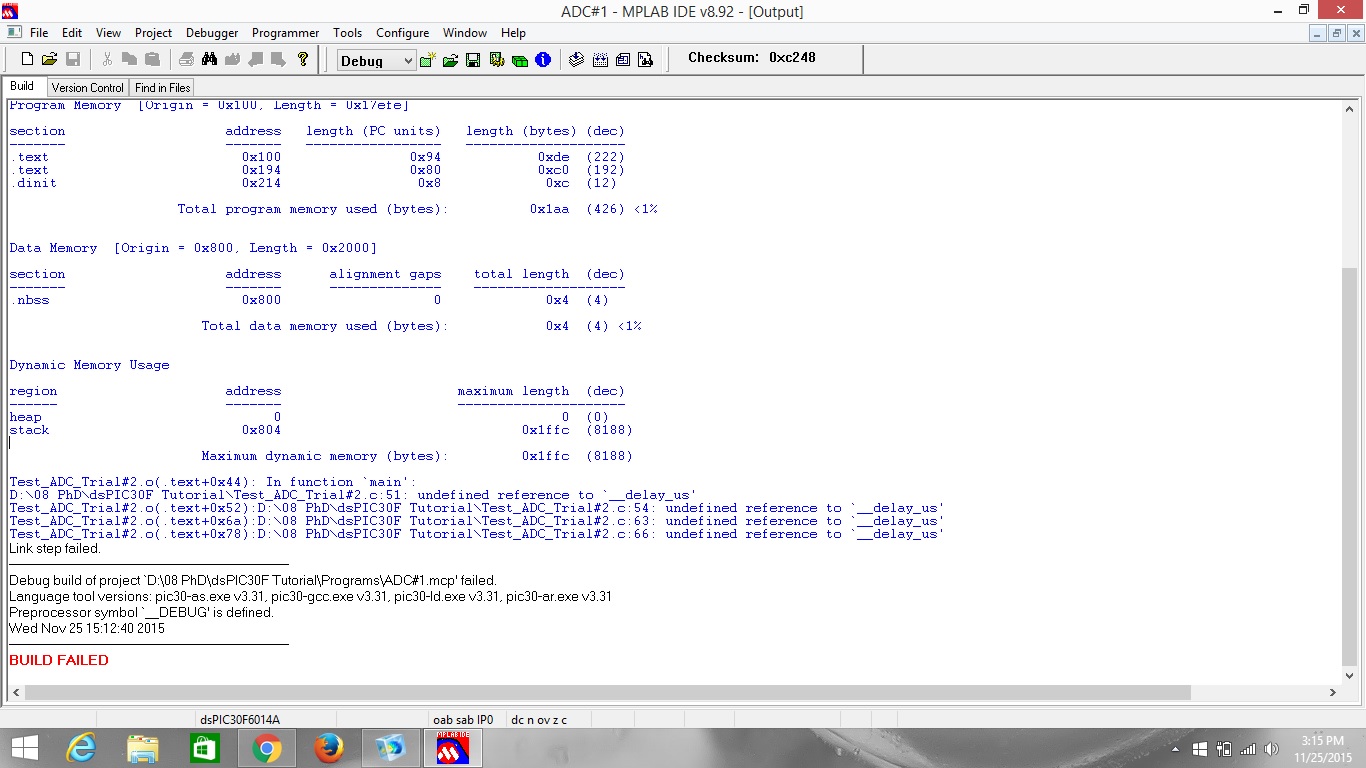

Postby arelone » Wed Nov 25, 2015 3:29 pm
Hi,
Thank you for your response. I attached the error message.
Regards
arelone
Posts: 3
Joined: Tue Nov 24, 2015 10:27 pm
Re: ADC dspic30f
Postby ober » Fri Nov 27, 2015 9:13 am
From the error message, the __delay_us() is not defined.
Where did that function come from? It is in C30 compiler or other compiler? Not all compiler have this function. As far as I use, the HITECH uses that for delay with condition you need to define the value of XTAL_FREQ, maybe the new MPLAB XC16 have that too.
Well, I would advise to use the correct compiler of where the original function is, else remove those function in error message.
You might get more error messages, solve 1 by 1.
BTW, no error message does not mean the code is working :)
