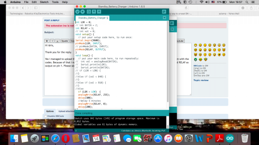

I just bought a cuteduino board and managed to upload my sketches couple of times. However during my last attempt to upload the program the system seems to be "hang" stopped at "running digispark uploader" " plug in device now". The pwr led at the cuteduino lighted but when i removed the usb cable to the cuteduino couple of times the uploading bar does not move. Hope somebody can help this newbie. Thank you.

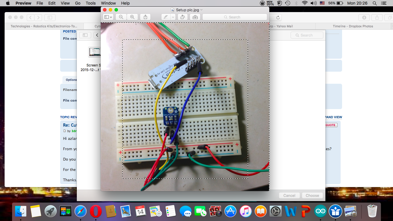

Yes i managed to upload the programs / sketches couple of times using Apple OS. It went well but i think i have problem with the codes. Because of that i reduced the codes to check where did i went wrong. Now i have only one input LDR on pin 0 and RELAY as output on pin 1. Please see attachment. In my earlier attempt i uploaded the program using usbserial port. However in my last attempt i kinda of lost the port and only have bluetooth-incoming-port and iPhone-WirelessiAP ports.

Hi azlanrp, thanks for sharing the photos.
From the hardware setup, it looks like you are using Vin, pin 3 (D-), pin 1, pin 0 and GND. Right?
For your information, Cuteduino is using pin 3 (D-) and pin 4 (D+/A2) for USB communication. When you connect these pins to any external hardware, it will disturb the USB communication, so that is one of the reason why your Macbook can't detect the Cuteduino.
Another advise, please do your wiring properly. From the photo you share, the possibility the Cuteduino's pin to short is high. You can use jumper like this to do connection.
About the coding, Cuteduino don't support standard Serial functions, so please remove Serial.begin(9600).
// Standby battery charger
int LDR = 0;
int RELAY = 1;
  pinMode(LDR, INPUT);
  pinMode(RELAY, OUTPUT);
  if(digitalRead(LDR) == LOW)
    digitalWrite(RELAY, HIGH);
    delay(2000); // Put more delay for relay change state
    digitalWrite(RELAY, LOW);
    delay(2000);
If you want to combine more condition in if statement, you can write like this.
Val = analogRead(A1); // Cuteduino pin 2
if(digitalRead(LDR) == LOW && Val > 840 && Val < 910)
Or you can write like this.
  if(Val > 840 && Val < 910)
