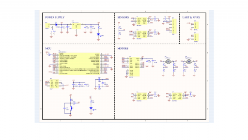

We have just updated the download files for Volume 4 of RH2T Mag, with Schematic of the Balancing robot. Sorry for late update, the author is busy designing stuff 8-) . You can download it from RH2T site, login is necessary to download. Vol.4

Postby choyhong88 » Wed Nov 23, 2011 11:17 am
from the schematic diagram , is it 3.3v enough to operate the RF receiver 433MHz? because the user manual states that it need 5+-0.5V
Balancing Robot schematic from cytron

choyhong88 WROTE:from the schematic diagram , is it 3.3v enough to operate the RF receiver 433MHz? because the user manual states that it need 5+-0.5V
Yup, the spec says it requires 5V, but we just simply test it and it works. Maybe the range will be shorter in that case.
Anyway, it may be depending on the module, some may work and some may not. Thus its functionality is not guaranteed.
The easiest way is to get your hand dirty and try it out ;)
