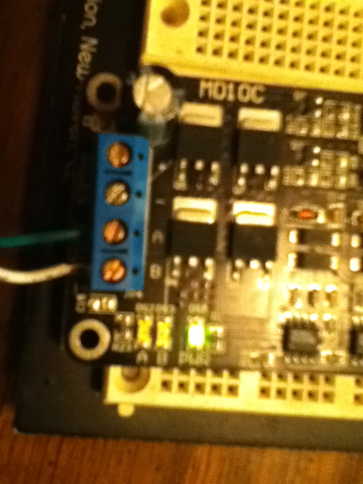

I am working on a project using Arduino Mega and MD10C. I seem to be unable to get my MD10C to work at all. I am right now testing MD10C using LED's and a 9V battery (small battery). I have the 9v battery plugged into power where a green led lights up saying pwr on. then I have 2 wires connected to the motor going to a LED. The board supply is put to pwr rather then Vin.
when I press the test button (A on the chip), nothing happens. When I press the test bottom (B on the chip), nothing happens. When I send a high pin (from the arduino) to pwm or DIR, nothing happens (along with a variety of combinations). I tried connected Vin and ground (where the Green pwr led lights up) and again tried it multiple times, but nothing happens.
Please let me know where I went wrong! All I want it to do is turn the motor on or off using signals from my arduino (I am using Processing in this case). I also have 2 of these chips and neither of them worked. is the battery I am using not sufficient enough to run the board and power the led's? but again I did have Vin and ground to power the board and that should be enough to light up a simple led. blahhh!! help please :)

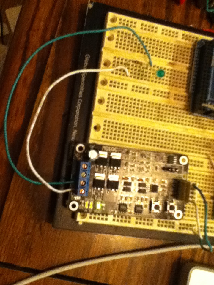

hi thanks for the reply. It still doesn't work. I uploaded two pictures. One showing the circuit and then one showing my connections of my "motor" and the green light.
with this connection, I press the "A" and "B" button and nothing happens (not even on the board where the A & B lights should light up). I made a pin on my arduino board on high and I hooked up a wire to the PWM; Nothing. I then did 2 wires, on high, to PWM and DIR; nothing again.

Hi, you need to connect the motor supply as well.

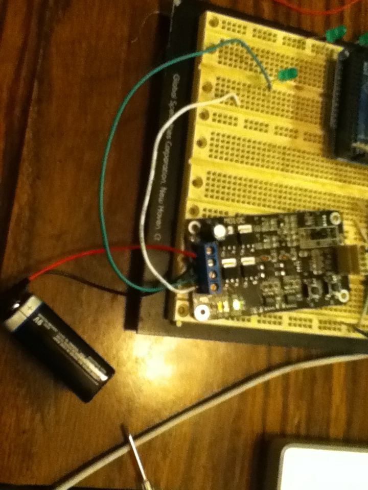

Postby swimfree2010 » Thu Jan 12, 2012 2:27 pm
ok. I added the battery... still nothing. :/
thats with pressing the buttons and touching the PWM and DIR pins with my high arduino pin.

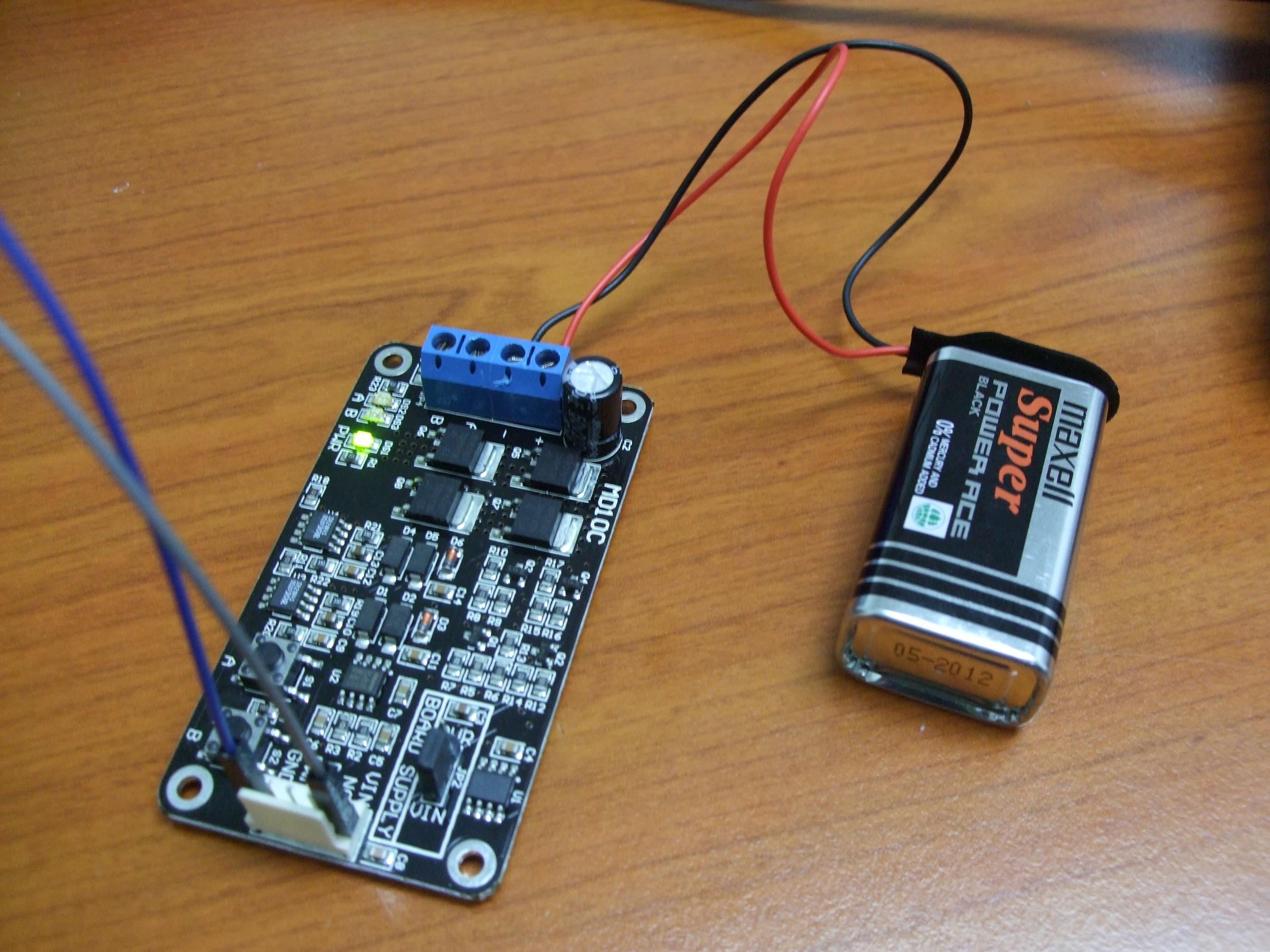

Postby ober » Sat Jan 14, 2012 12:27 pm
swimfree2010,
Here are some photos showing the basic setup.
This is the setup where 12V I get it from a modified ATX power supply using BB-ATXRA, the 9V battery is connected to POWER terminal. BECAREFUL with the polarity at VIN and POWER. Once you connect wrong polarity, the MD10C will not function. There is no polarity protection on this motor driver.
MD10C Basic Setup

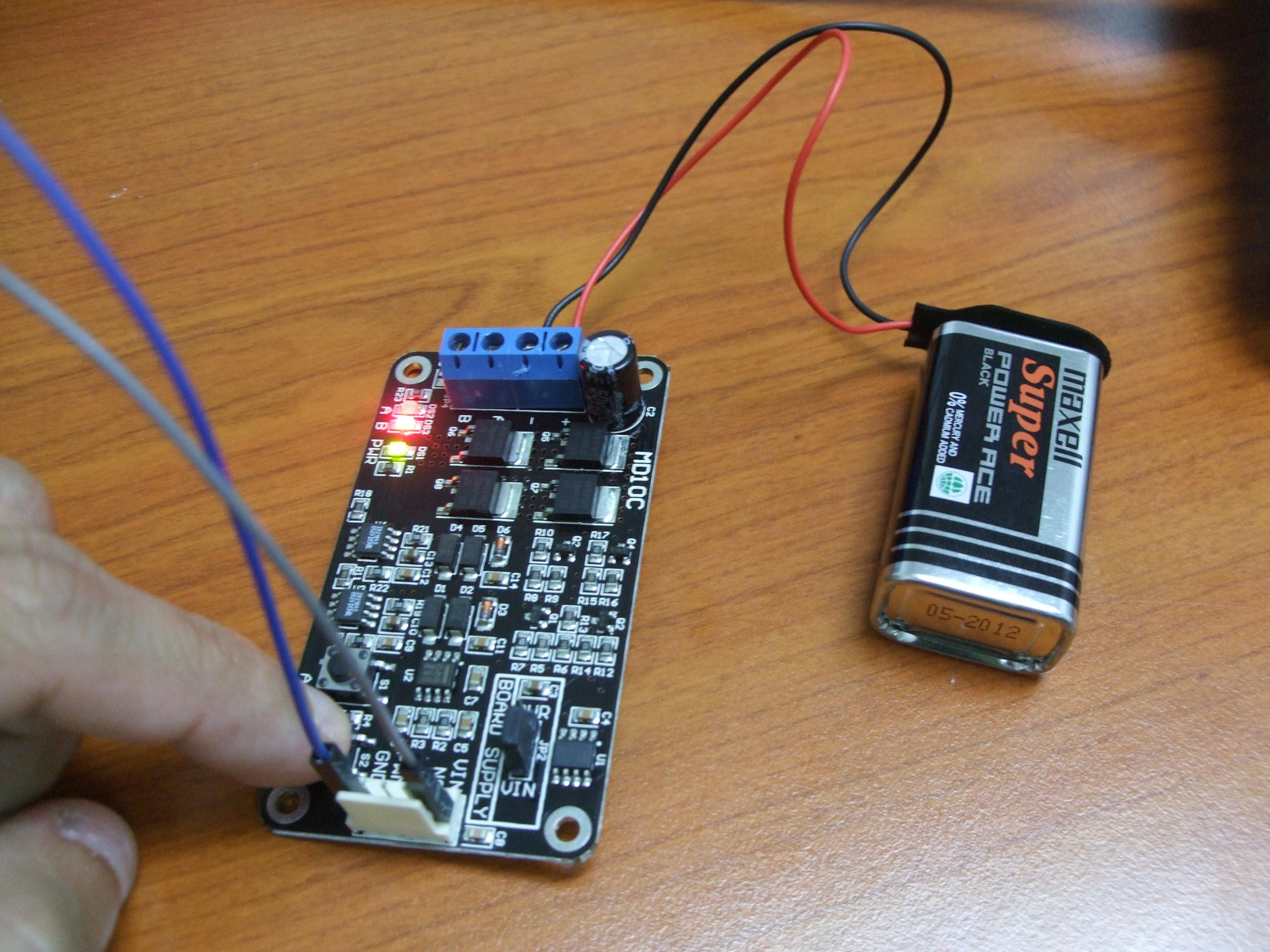

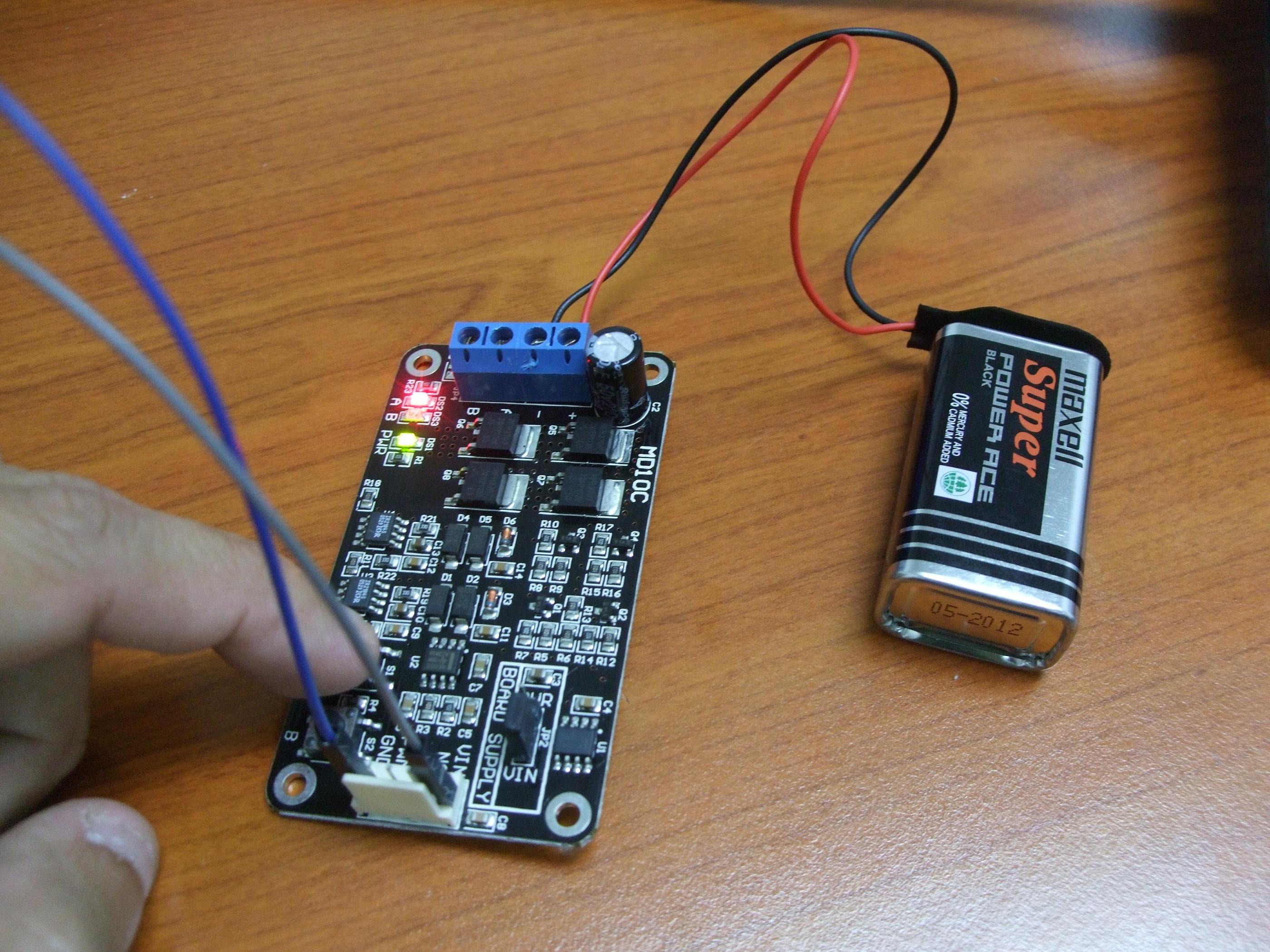

Here is another photo, pressing Button A, one of the red LED will activate. Same goes to button B, red LED (B) will activate.
Button A
Button B
Button B
Do make sure 12V is there and 9V battery have power and connected properly.
