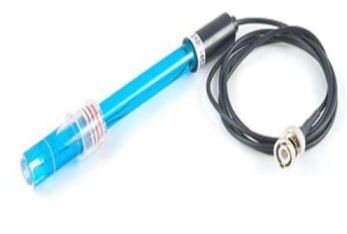

hye... i want to used arduino uno to connect with ph sensor... but i do not see the socket for put ph sensor to the arduino. can u hel me please...the ph sensor just like i attach, and what other hardware to connect it. thanks u...

Do you have the link of the sensor? Can you share more info on the sensor?
Re: Arduino and ph sensor
Postby robosang » Wed Sep 18, 2013 10:03 am
Seem like VNC connector :) Do let us know the datasheet of the sensor, if it is resistance base sensor, it should be fine to interface with Arduino.

I can't see your attachment, on mobile now.
is that the sensir same as http://shahrulnizam.com/pic-lesson-ph-sensor
it is use UART

yes... it same like the http://shahrulnizam.com/pic-lesson-ph-sensor, just difference colour maybe.

Hidayah WROTE:yes... it same like the http://shahrulnizam.com/pic-lesson-ph-sensor, just difference colour maybe.
You need to buy with the pH circuit from Atlas Scientific.

yes... i have buy ph sensor with ph circuit. thanks..
