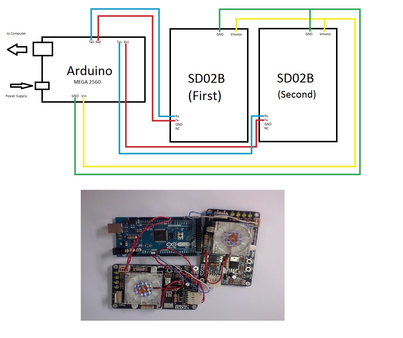

Share a few clear photos of the wiring connection and the sketch here.

Postby faisal » Fri Oct 04, 2013 12:11 pm
these are the sketch and the diagram for my project.
  Serial1.begin(9600);
  Serial.print('O');  // turn on stepper motor 1
  Serial.print('S');  // set speed
  Serial.write(10);   // to 10
  Serial.print('<');  // rotate counterclockwise
  Serial.print('M');  // set micro-stepping to
  Serial.write(1);    // 1
  Serial.print('G');  // run the stepper motor
  delay(3000);
  Serial1.print('O');  // turn on stepper motor 2
  Serial1.print('S');  // set speed
  Serial1.write(10);   // to 10
  Serial1.print('<');  // rotate counterclockwise
  Serial1.print('M');  // set micro-stepping to
  Serial1.write(1);    // 1
  Serial1.print('G');  // run the stepper motor
  delay(3000);

Postby sich » Thu Oct 10, 2013 4:38 pm
I've tested your code with my Mega 2560 and it works on both uart channels. Perhaps one of the SD02B is not working well. Have u tried to switch the two driver on different uart channel?

Postby faisal » Fri Oct 11, 2013 6:40 pm
Thanks for confirming the connection and the code. i found out the problem yesterday. there were 2 big problems. one is the Arduino's new IDE. i changed to the older version (version 0022), after searching for solution in here and also arduino's website. the second is the driver. one of them dont really work. when i push the test button, the LEDs blink, but when i upload the program, the motor doesnt move LEDs dont blink.
