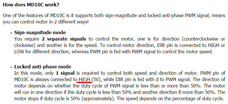

Postby Idris » Thu Feb 18, 2016 4:00 pm
Hi benjamin,
I'm noticed that you are using "LOCKED ANTI PHASE" method in your program. So you need to set PWM pin to HIGH to enable the motor driver. There have stated in the tutorial. You can either short the PWM pin to 5V pin or set it in the program.
I try to edit your 2nd code, let me know the result. Thanks.

Postby Idris » Fri Feb 19, 2016 8:45 am
Yes, for locked anti-phase, there will be audible noise produced by motor (even it is not moving). Because the voltage is still applied, just the amount of voltage for both terminals is same, that makes the motor didn't move.
You can try SIGN MAGNITUDE method if that noise really hurting you. However, you need to modify the coding.
