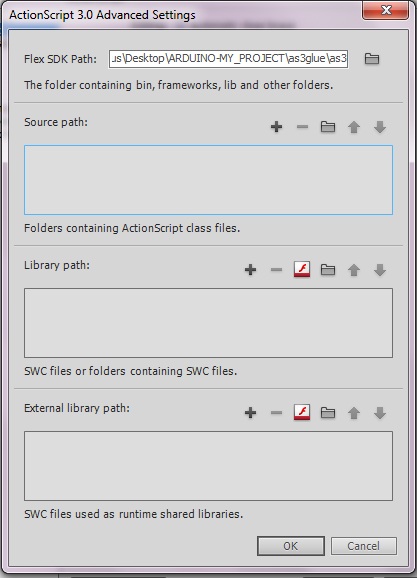

Postby fitri » Mon Nov 28, 2011 10:03 pm
in 1st image, i add the directory. is what im doing correct?

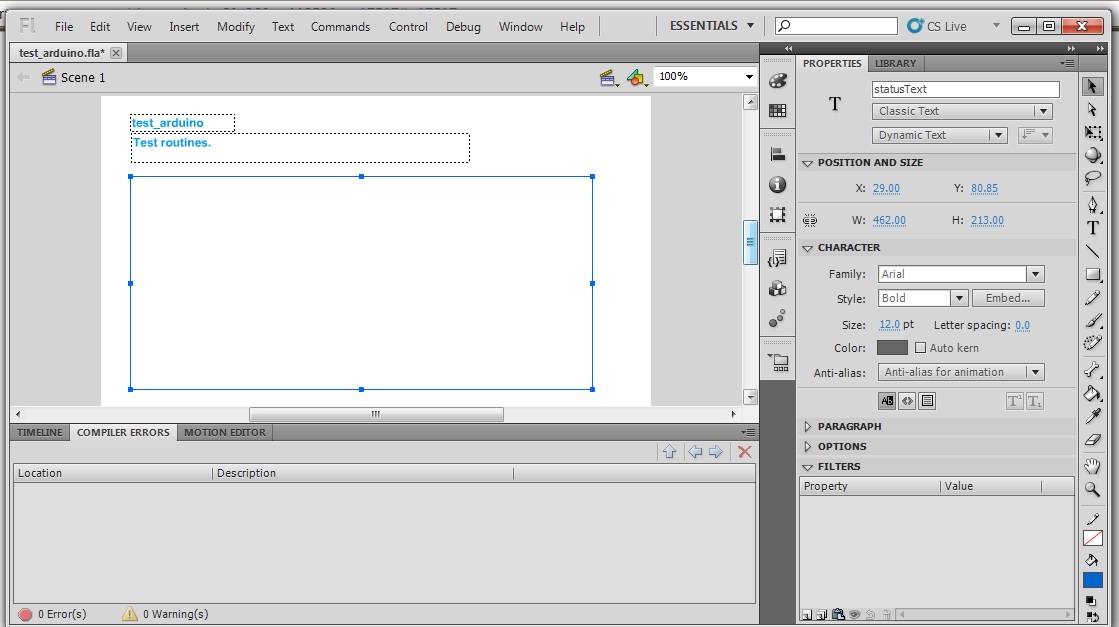

Postby fitri » Mon Nov 28, 2011 10:10 pm
i open cs247_examples/test_arduino.fla but its look empty..can anybody explain.. :cry:

Postby zhenning » Tue Nov 29, 2011 12:14 am
fitri WROTE:i open cs247_examples/test_arduino.fla but its look empty..can anybody explain.. :cry:
Just execute it. Its has actionscript 3.0 embedded in it ^_^

Postby zhenning » Tue Nov 29, 2011 4:27 pm
fitri WROTE:in 1st image, i add the directory. is what im doing correct?
Dont change the SDK path. Add it under source path =)
