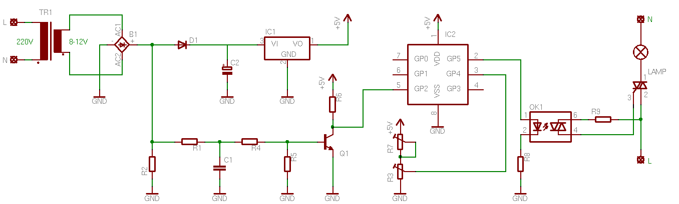

Are you talking about the mains 230V AC or some stepped down AC through a transformer. If you're trying to dim the lamp connected to 230V ac mains, you have to take precautions as the 230V will destroy the mcu if you're not careful. But still it is possible to do it through opto-coupler. I cant find any example using Arduino but there is one for the 12F615 PIC. The principle is the same.

Input GP2, I think for phase detector, either the AC source is positive cycle or negative cycle.

fitri WROTE:i try to do AC dimming light. my idea is just use the same program for dimming DC light. the problem is that i dont know the circuit. does anyone have the circuit? and do you all think my idea will work?
As you can see from the circuit. Dimming AC light is different from dimming DC light.
To dim AC light, you need to start cutting the sine wave at a fixed point e.g. at the points where the sine wave crosses the zero axis. But to dim DC light you just need to have a continuous PWM wave with different duty cycles to a MOSFET to control the brightness.

I wouldnt recommend the circuit to you unless you are an expert in electronics. The separation between the AC and DC is of minimum design. You can get electric shocks when testing or constructing the circuit. And besides, where are you going to get the +5V for the mcu, you'll need a stepdown transformer or an adaptor anyway? Can you just substitute the 110V ac and 110V lamp with 220V ac and 220V lamp ?

fitri WROTE:i want to control AC dimming light using digital button on arduino
In the circuit that I posted, you can replace the PIC with the Arduino. GP2 is a digital input, GP4 is analog input and GP5 is digital output. You can add 2 more buttons on the arduion as digital inputs for UP and DOWN function. So the rest are just software. Once your software is working, you can always remove the analog input.
The assembly program for PIC is included in the website and you have to understand it and convert it to the Arduion C for it to work.
