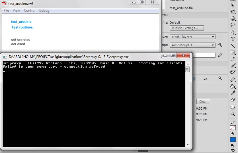

Postby fitri » Tue Nov 29, 2011 10:16 pm
zhenning WROTE:You are suppose to see some messages only whether the flash can connect to Serproxy or not. And another thing you need to run Serproxy.exe first before running the flash =)
thx :mrgreen:
i can run flash already..
but serproxy cannot open comm port. am i need to do some configuration 1st? :?:

Postby zhenning » Tue Nov 29, 2011 11:58 pm
thx :mrgreen:
You need to do some configuration. Make sure you have serial port or USB to serial. Then check the COM port no that connects to it. After that,
edit as3glue/applications/Serproxy-0.1.3-3/serproxy.cfg. using notepad++
PC: On my machine, Arduino uses COM3 - this is reflected in the line comm_ports=3 and < tt=""> below. If your board is on COM4, you'd have to change those lines to comm_ports=4 and net_port4=5331. Here is the complete config file:

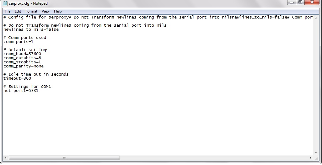

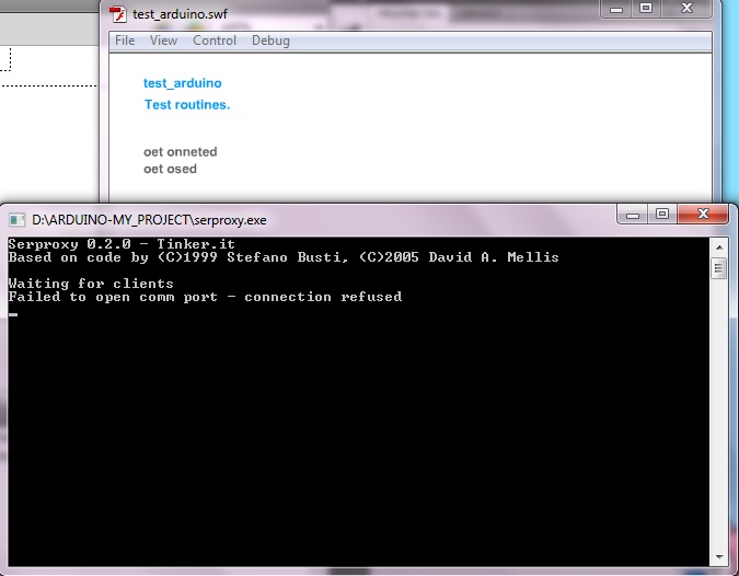

i already do the serproxy configuration. im using com1. do i need to change comm_baud rate?
and do i also need to run arduino IDE?
attached is what i configure and the result i got..need ur guide on this, thx sir :oops:
serproxy_config
result

Postby zhenning » Thu Dec 01, 2011 12:04 am
fitri WROTE:
zhenning WROTE:You should see something like this :
In Flash should display a message like this:
Socket connected!
Firmware version: 1
Port: 5331
The serproxy window should show something like this:
Server thread launched
server(4) - thread started
thx for ur info,
Did you connect your board? If i am not mistaken, you have to connect it. Else it couldnt find the device.Please read the link you posted thoroughly.

Postby fitri » Thu Dec 01, 2011 11:01 pm
thank you so much zhenning :D
i already can connect it.
1st i need to connect the board.
2nd configure the serproxy and run it
3rd run the fla. file
