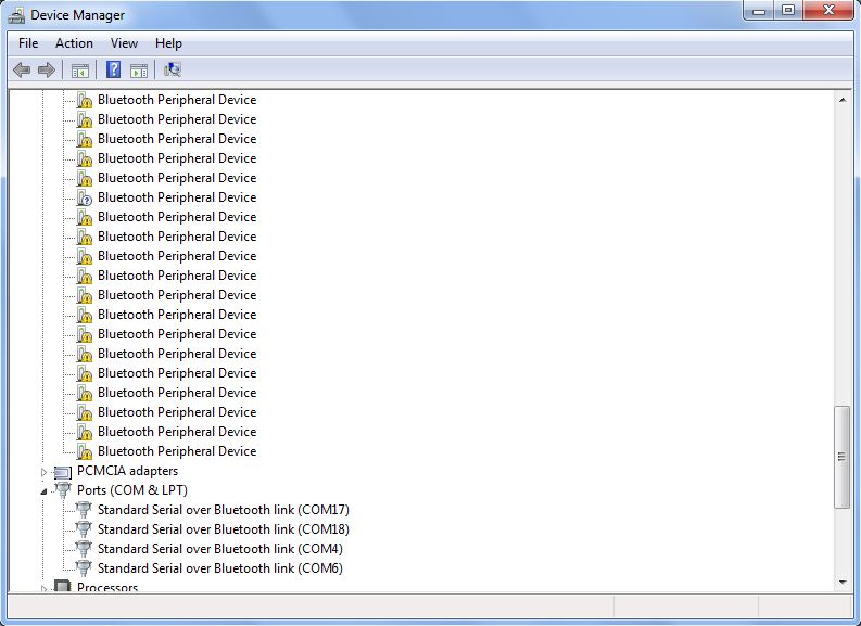

Re: Cannot read usb arduino
Postby Hidayah » Sun Oct 06, 2013 7:08 pm
thanks.... i have found my port arduino uno, but why my computer have many Bluetooth peripheral device? like the picture...
Hidayah
Posts: 30
Joined: Thu Jun 06, 2013 12:12 am
Postby faisal » Mon Oct 07, 2013 11:26 am
i think it doesnt matter. but if u are bothered by it, maybe just right click the name of the device one by one and then click disable? if u dont have bluetooth devices and dont intend to use it, i think it is ok to just disable those. if i am wrong, i hope someone can come and say that. :?
