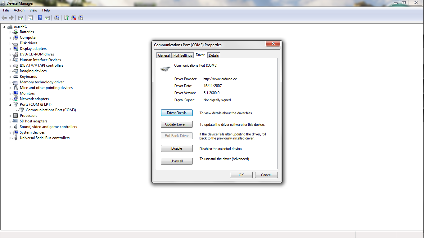

Postby AGPDL » Wed Dec 14, 2011 12:22 pm
Hi Sich,
Attached is the screenshot. Could it be that the bootloader is missing ?

Re: cant detect arduino board on laptop
Postby robosang » Wed Dec 14, 2011 1:28 pm
I don think is due to bootloader. It seem your computer does not detect the USB to UART chip on Arduino board at all. Are you sure it is plug in?
Postby AGPDL » Wed Dec 14, 2011 2:22 pm
Yes, it is plugged in. When I disconnect the cable, the Device Manager refreshes, the Com3 does not show anymore. When I connect it again, Com3 appears again.
