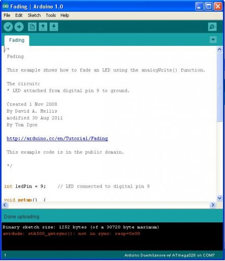

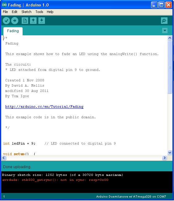

last night i just want to give it a try to test my arduino board..so i download one of example program..but the Led does not act as desired..
the arduino environment show as below:
is this mean my arduino spoiled?
fitri

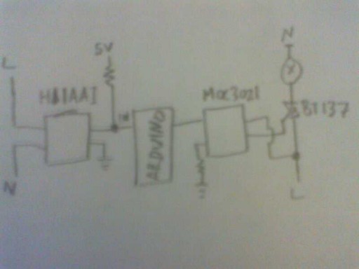

Postby fitri » Sat Mar 10, 2012 4:11 pm
this is how i connect the circuit...sorry i dont have any CAD software...

Postby ABSF » Sat Mar 10, 2012 5:02 pm

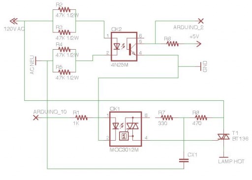

Actually your circuit should look something like this:
AC control from Arduino forum
The 120V AC is connected to the LED side of the optocoupler through 4x 47K resistors . The LED inside the opto has a Vf of 1.5Volts. The 4x 47K is used to drop 120-1.5=118.5V of the AC. The current through the LED is about 2.5mA. Since you're connecting to 220V you have to recalculate the value of the 4 resistors. Or else if the LED punches through and burn the transistor the high voltage would go into the Arduino pin_2 and toast the AVR. If you're lucky only the AVR is spoilt or else some other components on the Arduino board might also be toasted.
The values of R7, R8 and T1 might have to be changed/recalculated if you want it to work on 220V. The MOC3021 might have to be changed to one with ZCC and able to withstand 400V AC.

ABSF WROTE:Actually your circuit should look something like this:
this is my understanding,
4N25M use for arduino input = use to detect zero crossing of AC
MOC3012 replace with MOC3041, =this use to trigger bt137
all resistor need to calculate back.
