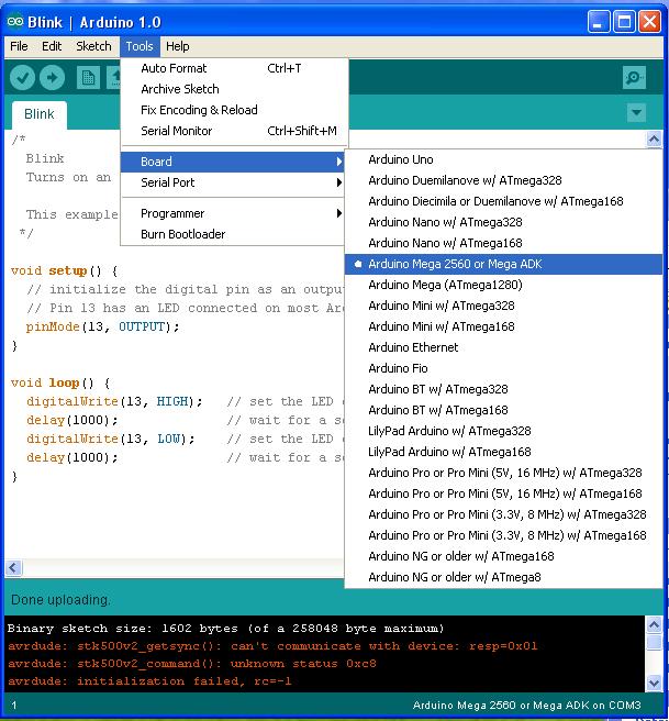

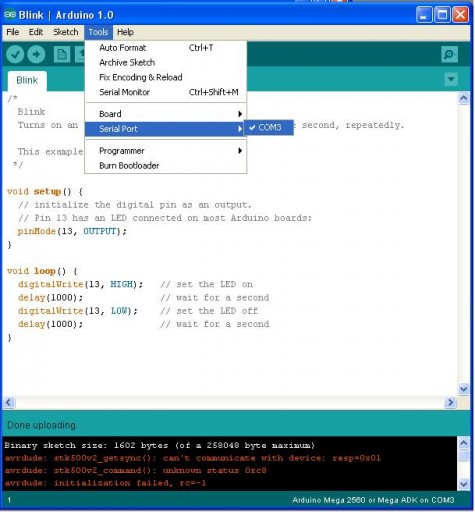

Postby fitri » Fri Mar 23, 2012 8:20 am
Hi all,
i still got no idea how to communicate my pc with arduino mega...need help :(
how to establish the communication....
attached is the print screen..
please some one help me since i never success using my new arduino mega.. :( :cry:
