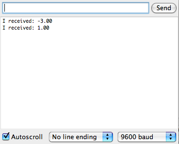

Hi. Can anyone tell me on how can i put a negative number into the serial monitor? Everytime i put a -1 (for example), this happens:
Screen Shot 2012-11-06 at 1.30.05 PM.png (18.21 KiB) Viewed 3434 times
It seems that the serial monitor reads a minus sign as -3, then read 1 as 1 (which is correct, except the negative sign).

inByte is char (8 bit value)
Then you type '-' & '1'. 2 character.
ASCII for '-' equal to 45. Then 45 minus 48, it get -3.
