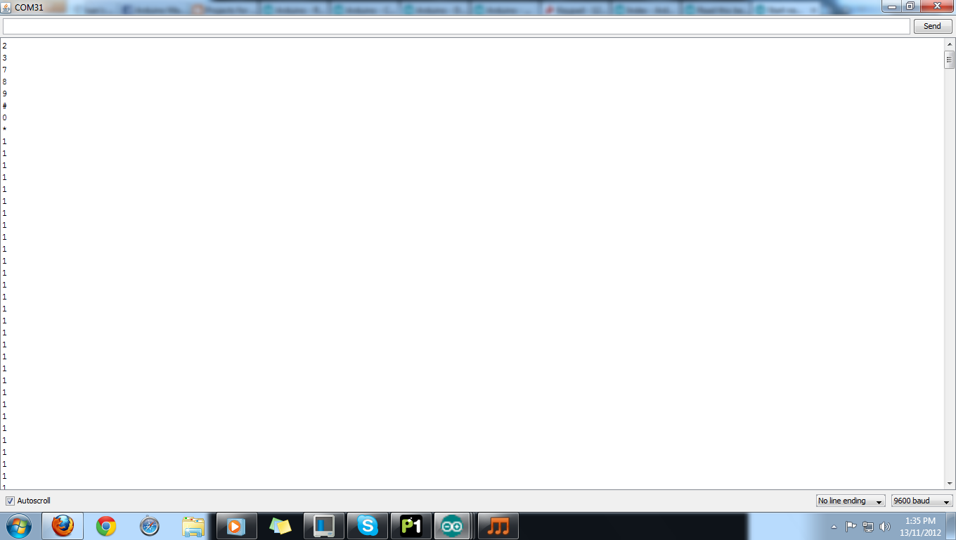

Postby mr_hacker90 » Tue Nov 13, 2012 2:19 pm
hi. hello everyone. i have a question here. how do i escape while control structure with implement of switch case. basically. i'm using 3x4 keypad. i want to display in serial monitor number 1 when i press keypad number 1 repeatedly until other number is being pressed. currently i managed to display number 1 until 0 in serial monitor. however, when i pressed the keypad, it just shows in serial monitor the number once only. i want to modify the program so that it will display the number repeatedly until the other number is pressed. here is the programming code. the keypad programming code is referred on the arduino playground. http://arduino.cc/playground/Main/KeypadTutorial and the while control structure is referred on the arduino reference http://arduino.cc/en/Reference/While. the program code i have modify already a little bit. but, seems no going as i planned. if i put the while control structure, the number that i pressed display repeatedly however it not break to other keypad numbers. in the programming code, i have made the change under case '1'. i also provide the screenshot of the serial monitor. managed to display number 1 repeatedly, however, did not break the while loop when the other keypad number is being pressed. your help, i really appreciate. thank you.

Postby shahrul » Tue Nov 13, 2012 4:18 pm
I'm not familiar with Arduino keypad library. Maybe you need to delete " if(key) " in your program.
Also you can do read keypad on your own ex Keypad Lesson.
Re: How to escape while control structure with implement of
Postby Alen.ATLow » Thu Nov 15, 2012 3:57 pm
switch (key)
case '1':
while(key == '1'){
Serial.println("1");
key = kpd.getKey();
break;
