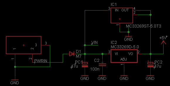

Postby zhenning » Thu Nov 15, 2012 3:53 pm
Alen.ATLow WROTE:I wonder can we improve this by applying forward bias diode to prevent the voltage flow from higher potential to lower potential source of both USB and External Power supply.
Bricking up Mega is not a big pain compare to having out USB port burn up. haha
Its there already :) If you see the section after the DC Jack in the sch . There is a diode ^^
[attachment=0]ScreenHunter_11 Nov. 15 15.55.png[/attachment
ScreenHunter_11 Nov. 15 15.55.png (4.38 KiB) Viewed 4347 times

Postby Alen.ATLow » Fri Nov 16, 2012 1:08 am
what about USB VCC ?

Postby robosang » Fri Nov 16, 2012 10:08 am
I guess putting a diode will lower the voltage from USB by 0.3V, though is not much but for ADC application might affect a lot.
I don have the Mega, so can only study schematic :)
