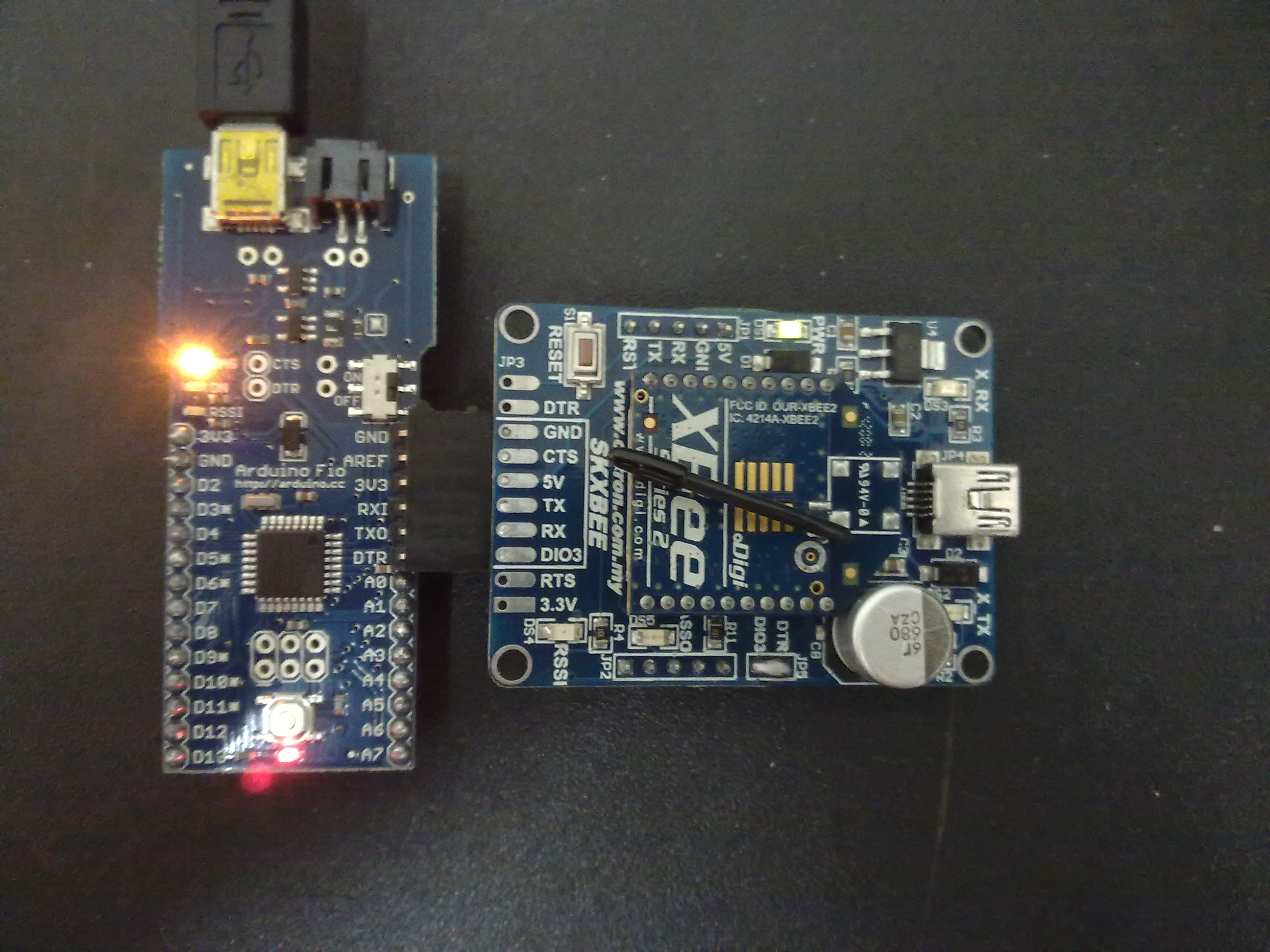

Postby ckchan23 » Tue Apr 23, 2013 5:16 pm
Hi all,
I'm encountering the same problem with Mr.sanazbehbahani with the following error:
avrdude: stk500_getsync(): not in sync: resp=0x32
By the way, the wireless devices that i'm using are xbee series 2 and i have followed some setting on xbee by the tutorial http://tutorial.cytron.com.my/2012/12/0 ... duino-fio/
But it still din't work and keep uploading sketch failed. Here is my decives connection and shown in the picture that i have uploaded.
Remote xbee connection
ckchan23
Joined: Tue Apr 23, 2013 4:37 pm
Re: Problem with Arduino Fio Wireless programming
Postby robosang » Tue Apr 23, 2013 9:22 pm
Are you kidding me? I went through the tutorial link that you give and I cannot see any photo showing your connection? Reading it further, the XBee should be connected on the back of Fio, not using the SKXBee as shown by you. Also the tutorial is using XBee S1, not S2.
Are you sure you are doing it correctly?

Postby Jonathan Law » Thu May 02, 2013 1:13 pm
I dun understand why u connect base XBee GND,CTS,5VTX,RX and DIO3 with your Arduino Fio board.
This connection definitely wrong! btw, where is your Remote Xbee?
They should be in pair, if not how you going to establish connection between XBee?
Please check again the tutorial provided by cytron,
http://tutorial.cytron.com.my/2012/12/03/getting-started-with-arduino-fio/
It might help you better
