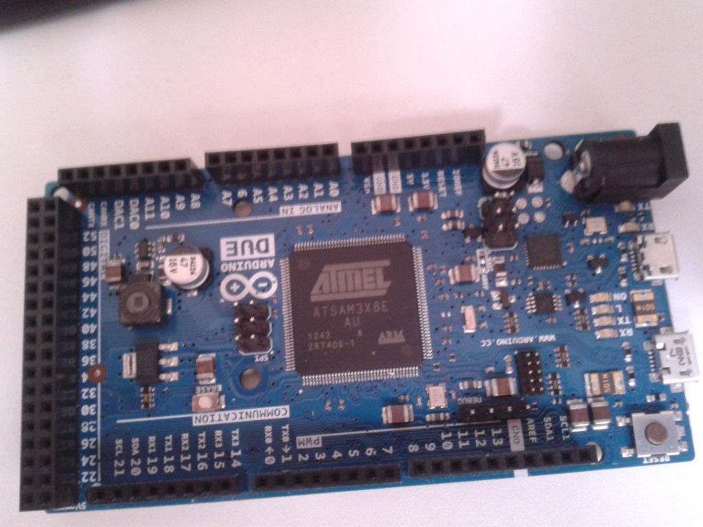

Here it is, the 32-bit Arduino, opened from the package.
Arduino Due
This is powered by Atmel's AT91SAM3X8E using ARM Cortex-M3 core, with an SD-Card control system and a multi-pipeline DMA controller. Plus, it has a lot of pins too, so you can interface with whatever things you want to do on it, like a small TFT screen or anything else.
For some of us who do like to make music - there is a 12-bit DAC on it. And there are other things in the Cortex-M3 which you can do faster signal processing inside.

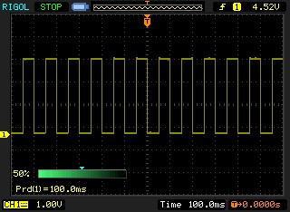

Prior to enabling the timer, the peripheral clock is disabled by default. You have to turn them on first, and then you can switch on the remaining TC registers.
This example code toggles the pin12 on the Due for every 50ms. It's a square wave, of course. The prescaler is 128 (84MHz/128) and the period to trigger the interrup is 32768 (REG_TC0_RC0). The maximum counter value is 0xffff only on that processor.
