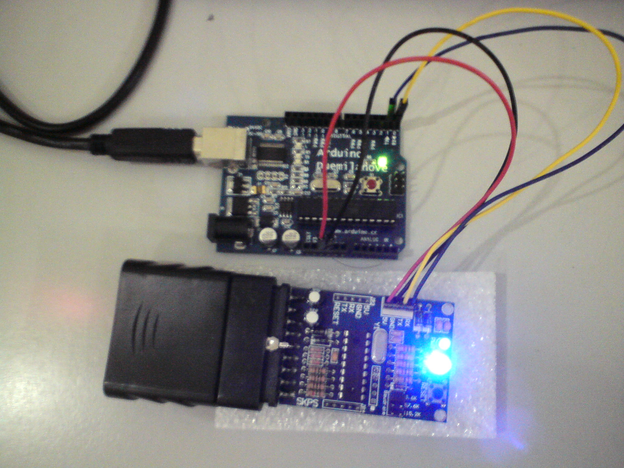

Well, as I always stress.... picture of hardware please.

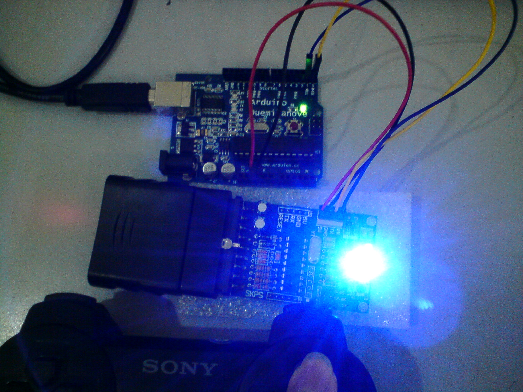

For my code,when triangle button on PS2 pressed, pin 13 led (marked L) should light up.
But still didt works, when i pressed the triangle button, SKPS status LED give 100% brightness,but LED pin 13 didt lights up.
i think SKPS works well to receive data from PS2 wireless controller but i have no idea whats going wrong.

i uploaded the picture regarding my hardware connection for your reference.
Thanks
Hardware connection
After triangle button at PS2 controller pressed
