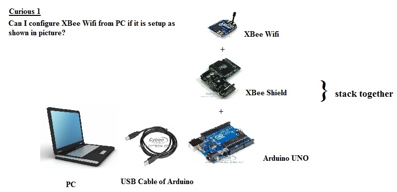

Curious 1
Can I program my XBee Wifi module by plug in Arduino UNO to my PC using UART ?? If can, then by using what method? X-CTU also?? Because I don wish to buy extra SKXBee just to program XBee Wifi.

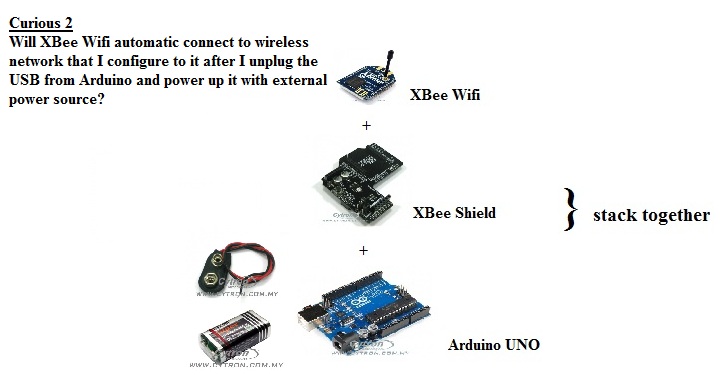

Curious 2
Let said I had successfully configure XBee Wifi to connect to my home wireless network A. Then I unplug the Arduino Uno from my PC. Now I power up Arduino UNO by using external power source such as battery. And XBee Wifi is still together with XBee shield and Arduino UNO. Will XBee Wifi automatic connect to wireless network A after I power up Arduino UNO??

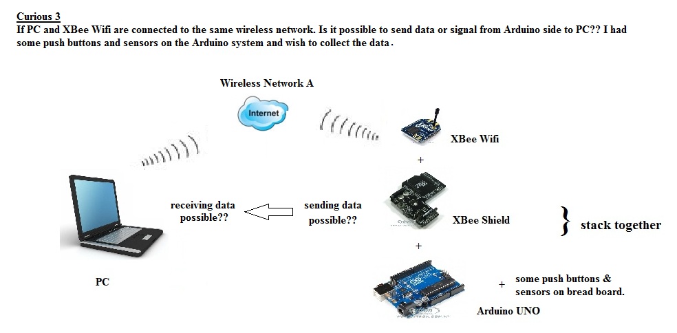

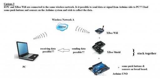

Curious 3
Let said XBee Wifi successfully connect to wireless network A. And I make my PC also connect to wireless network A. I had a push button on my Arduino System. When I press the button, can the signal send to PC through the wireless network A?? That mean send from microcontroller side to PC side through wireless network.

Curious 1 Picture
Curious 1

Curious 2 Picture
Curious 2

Curious 3 Picture
Curious 3

But now problem is Q3. Because I am sending signal from Arduino to PC, not PC to Arduino.
How can I receive data from Arduino to PC through XBee Wifi? I had test. I cannot collect data from sensor or push button that on my configuration of system. It cannot do with no wire (USB).
If I plug in USB, I can see some signal on XCTU terminal. But if I put it wireless without cable (I power up with external power supply), I cannot see the signal in XCTU because XCTU need to connect through COM port. XCTU cannot connect to XBee Wifi through TCP/IP. Thus I was unable to connect with XBee Wifi module then cannot see anything in XCTU terminal.
How can my PC connect to XBee Wfi module through wireless?? Because I cannot connect it to COM port and detect it and look at XCTU terminal to collect data. I don wan use cable between PC and Arduino. How to connect PC and XBee Wifi wirelessly? TCP/IP?? How to do that?
