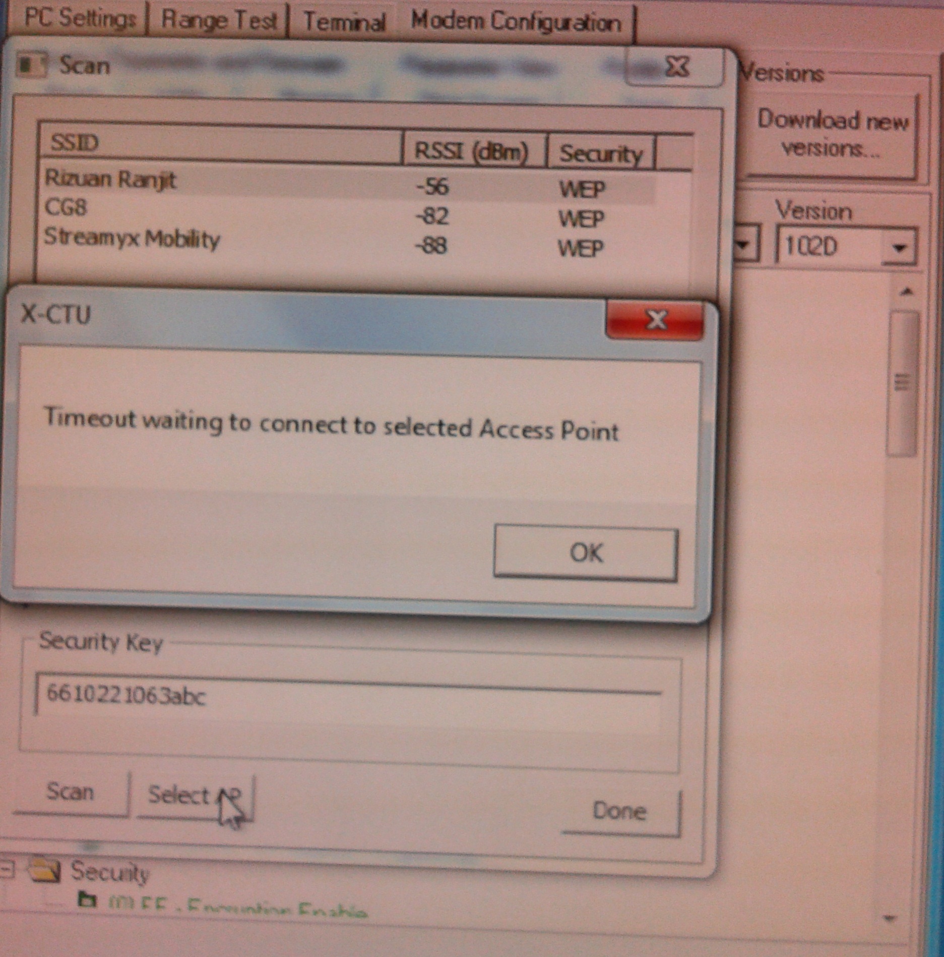

1. I have an arduino uno + Xbee wifi Shield + Xbee Wifi S6 Module
2. I tried to configure it with X-CTU Software and the software detect it
3. Then I scan for network in modem configuration. When I tried to connect to my network, this came out "Timeout Waiting to connect to selected access point".
What should I do?

Postby rkosharil » Sun Apr 28, 2013 1:17 pm
Here is the picture of the problem I'm having :
X-CTU. Can Read The Module but Can't Connect To My Network.

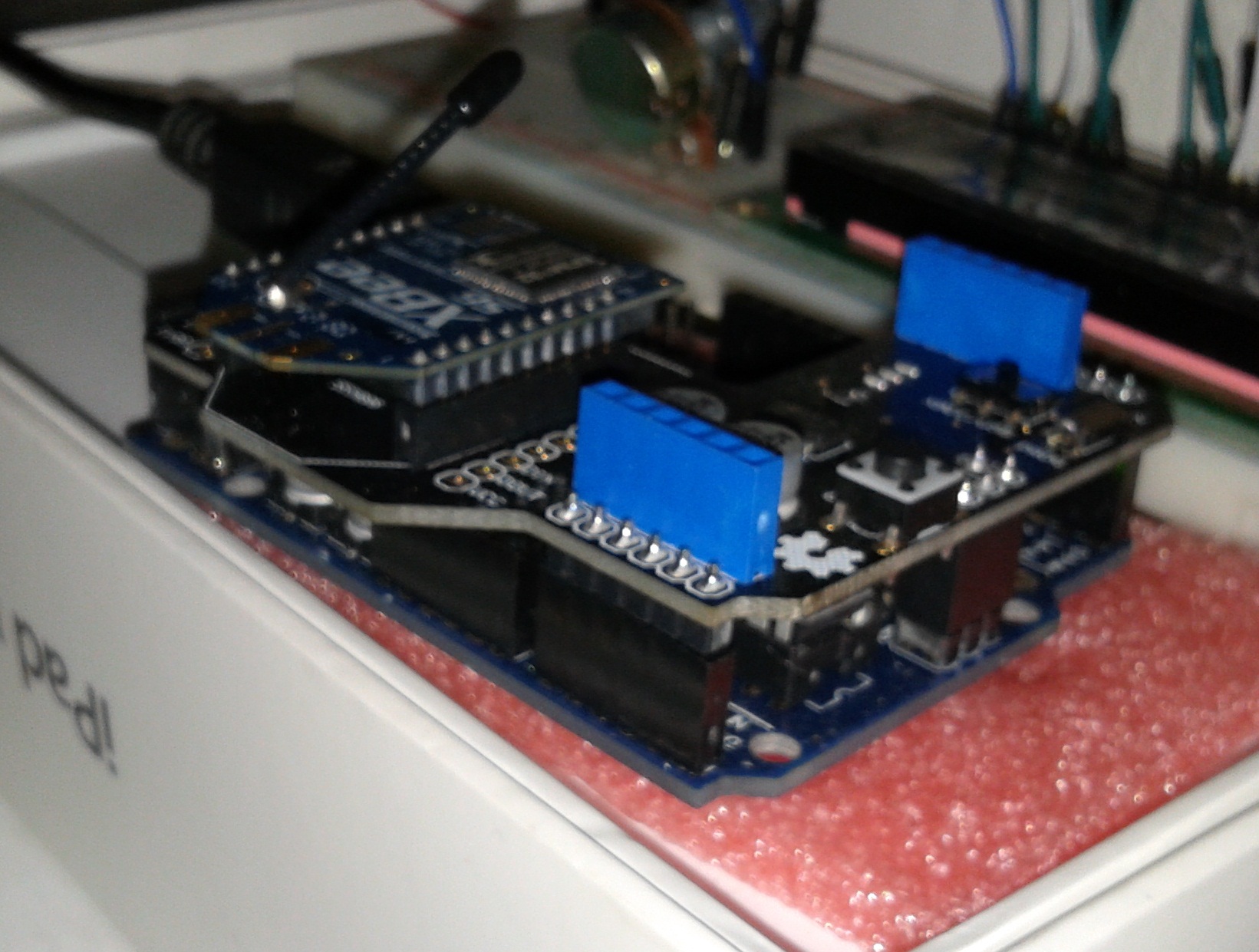

the hardware setup....
Re: Arduino with Xbee Wifi Module Configuration
Postby rkosharil » Mon Apr 29, 2013 12:12 am
Ok Here is the picture:

Postby robosang » Mon Apr 29, 2013 9:40 pm
If you check the XBee-WiFi Development Kit Getting Started Guide, page 13:Warning: The XBee Wi‐Fi module will not connect to access points or routers that use WEP or Enterprise security. The access point or router needs to be configured for DHCP
for the purposes of this guide.
