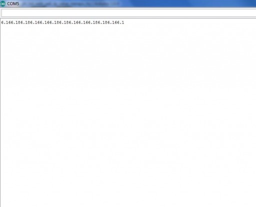

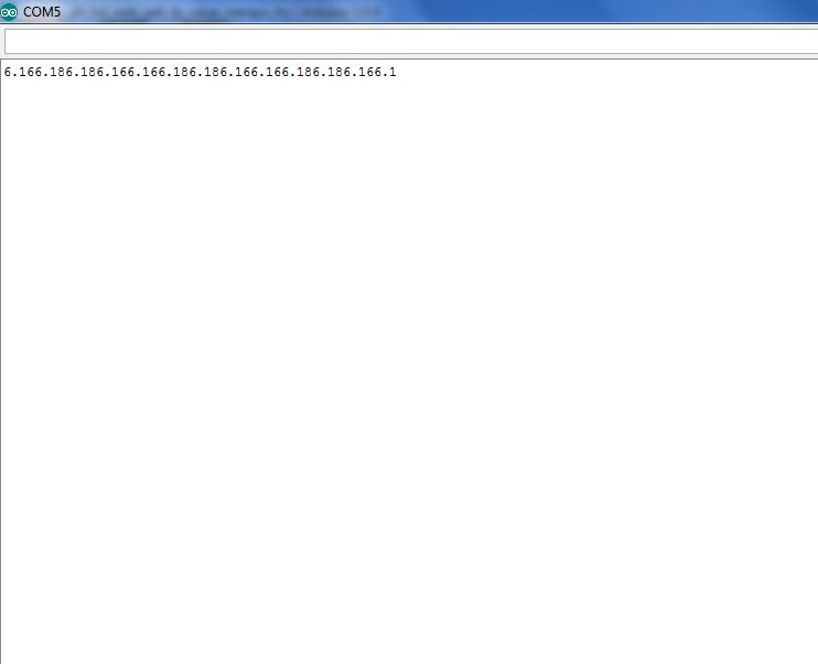

hye there... im used ph sensor and arduino uno...
why my result is display at LCd and serial monitor is 8 ph value each time? like picture below...and the ph print that should appear is not appear at
and here is coding that i used...thanks...

Postby atuk5259 » Mon Dec 16, 2013 5:17 pm
1-Ph sensor come with storage liquid (small bottle).. are u remove the buffer liquid and test at actual or buffer liquid (calibration liquid) ?...
2-Your sensor reading is 6.XX....not 8.XX.
3-pls caibrate your sensor to get actual reading..(refer datasheet)
