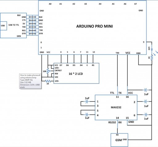

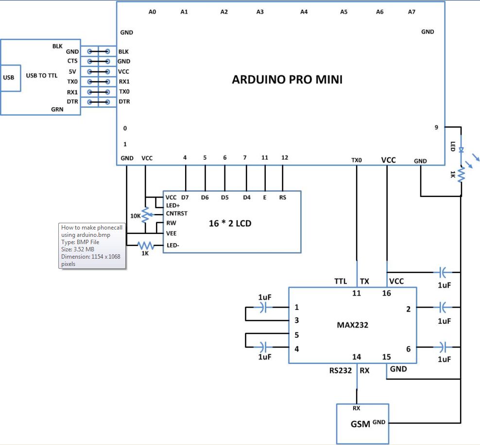

Does anyone can guide me on how to construct/starting this project? there is one project i found regarding this integration project but the project failed. Herewith i attached the coding for arduino and shcematic diagram. Below is the coding:
/*============================ EG LABS ===================================//
 Demonstration on how to interface GSM module and make a call
 The circuit:
 LCD:
 * LCD RS pin to digital pin 12
 * LCD Enable pin to digital pin 11
 * LCD D4 pin to digital pin 7
 * LCD D5 pin to digital pin 6
 * LCD D6 pin to digital pin 5
 * LCD D7 pin to digital pin 4
 * LCD R/W pin to ground
 * 10K resistor:
 * ends to +5V and ground
 * wiper to LCD pin 3
 * LED anode attached to digital output 9
 * LED cathode attached to ground through a 1K resistor
 GSM:
 RX PIN OF GSM TO TX0 PIN OF ARDUINO
 SHORT THE GROUND PINS OF ARDUINO AND GSM
============================== EG LABS ===================================*/
#include <LiquidCrystal.h>
// initialize the library with the numbers of the interface pins
LiquidCrystal lcd(12, 11, 7, 6, 5, 4);
// give the pin a name:
int led = 9;
  pinMode(9, OUTPUT);
  lcd.begin(16, 2);
  lcd.print("ENGINEERS GARAGE");
  lcd.setCursor(0, 1);
  lcd.print("   GSM CALLING  ");
  // initialize the led pin as an output.
  pinMode(led, OUTPUT);
  // start serial port at 9600 bps
  // wait for a while till the serial port is ready
  delay(100);
  Serial.print("ATD0123456789;\n\r");
    digitalWrite(led, HIGH);
    delay(1000);
    digitalWrite(led, LOW);
    delay(1000);

Hi mzakmal87,
Do you have test the GSM with the computer first? Just want to make sure it is working before do all the wiring with the microcontroller. Less troubleshooting.
Re: Arduino pro mini + GSM TC35
Postby mzakmal87 » Wed Feb 12, 2014 4:42 pm
I already test the GSM using hyperterminal and it can works well..i dont know whether the circuit is correct or not?
mzakmal87
Joined: Mon Feb 10, 2014 8:45 am
Postby Idris » Wed Feb 12, 2014 5:00 pm
mzakmal87 WROTE:I already test the GSM using hyperterminal and it can works well..i dont know whether the circuit is correct or not?
Thanks for your verification. If you don't mind, could you post your hardware picture here? Show all the connection.
Postby mzakmal87 » Thu Feb 13, 2014 8:18 am
i already disassemble the component and FYI the connection exactly the same as in the cct that i attached.
mzakmal87
Postby Idris » Thu Feb 13, 2014 11:55 am
mzakmal87 WROTE:i already disassemble the component and FYI the connection exactly the same as in the cct that i attached.
Ok, sorry for your inconvenience. Just another verification, which RX pin did you connect on the GSM board? The DB9 connector or TTL pins?
