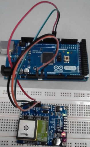

Mind sharing the photo of hardware setup?
Besides, is the LED at G_TX blink?
Re: skgps53 and arduino mega
Postby sitimariam » Tue Mar 11, 2014 12:09 pm
this is the hardware setup..and the led of G-TX is blink when i connect with the laptop..
