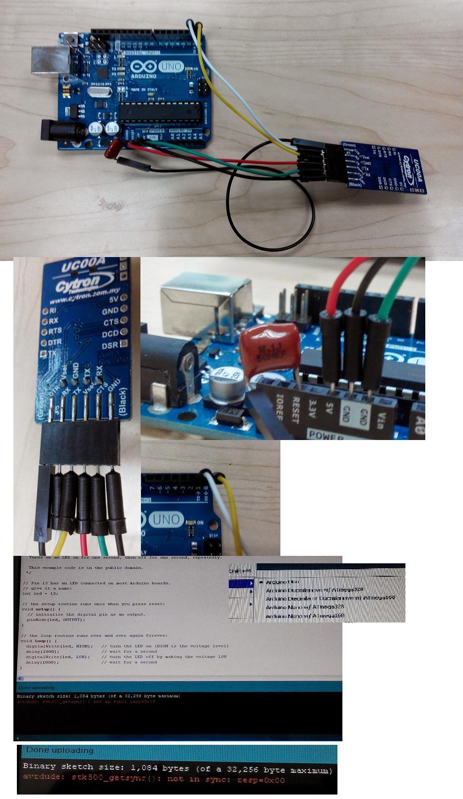

Well, a picture of actual hardware and wiring will be helpful.
Re: Arduino Uno with UC00A(FTDI FT232)
Postby bskhoo » Wed Jul 16, 2014 10:55 am
Ober,
Attached is the photos in detail on pins connection and software error.
Arduino Uno / UC00A connection
Thks. - BS

Postby ober » Thu Jul 17, 2014 8:43 pm
We have never tried this method to load program into Arduino UNO before since there is on board USB to serial ready to be used.
Anyway the method to load program using UC00A Rev2.0 is being done with BBFuino and it is working fine.
In your case, it might fail because the on board USB to UART is pulling the TX pin (RX of ATmega328) high and UC00A R2 cannot transmit data to Atmega328 properly.
