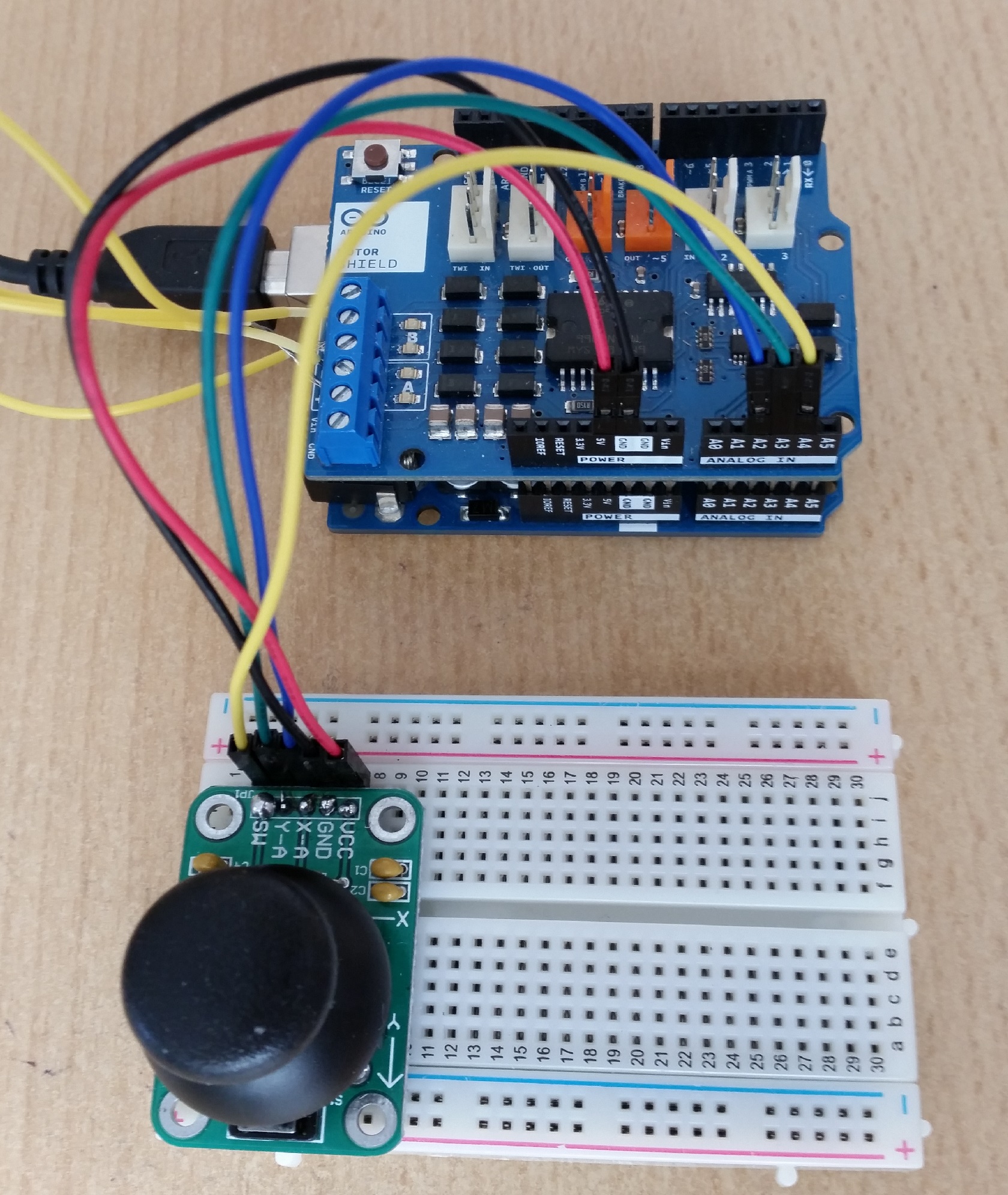

Postby Tranber72 » Mon Dec 01, 2014 9:28 pm
A DC motor on the X axis: mobilizing the object horizontally (forward and backward)
A DC motor on the Y axis: mobilizing the object vertically (forward and backward)
An Arduino Motor shield V3 map including: Motor Shield V3 Arduino + Arduino Mega 2560 Rev3
A plaque assay, 10 ohm resistors, potentiometers breadboard cables for M / M
A joystick with integrated card deployment: http://www.robotshop.com/en/cytron-mini ... ensor.html
I wish that the object can move with the joystick in the direction X or Y or both simultaneously in a constant speed. When the joystick is on a neutral position, I wish that the motors are off.
I've worked on the code but actually it doesn't work : the motors are moving randomly even if the joystick can influence them a little bit. Can you help me ?
Thank you
You can see on the photo of my first try with only the joystick and the motors
And here is my code wich doesn't work actually

Re: Joystick motorshield 2 DC motors
Postby yonghui » Tue Dec 02, 2014 7:39 am
Hi, quite hard to read the code u posted, but for the joystick, suggested u put some dead zone near the zero of x and y axes, means for example analog values of 0 to 5 on both x and y axes is assumed zero and motor don't move.
