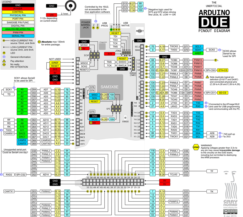

I'm wonder why do you bend A4 and A5 pins on the ethernet shield. It is only analog pin on Arduino Due.
