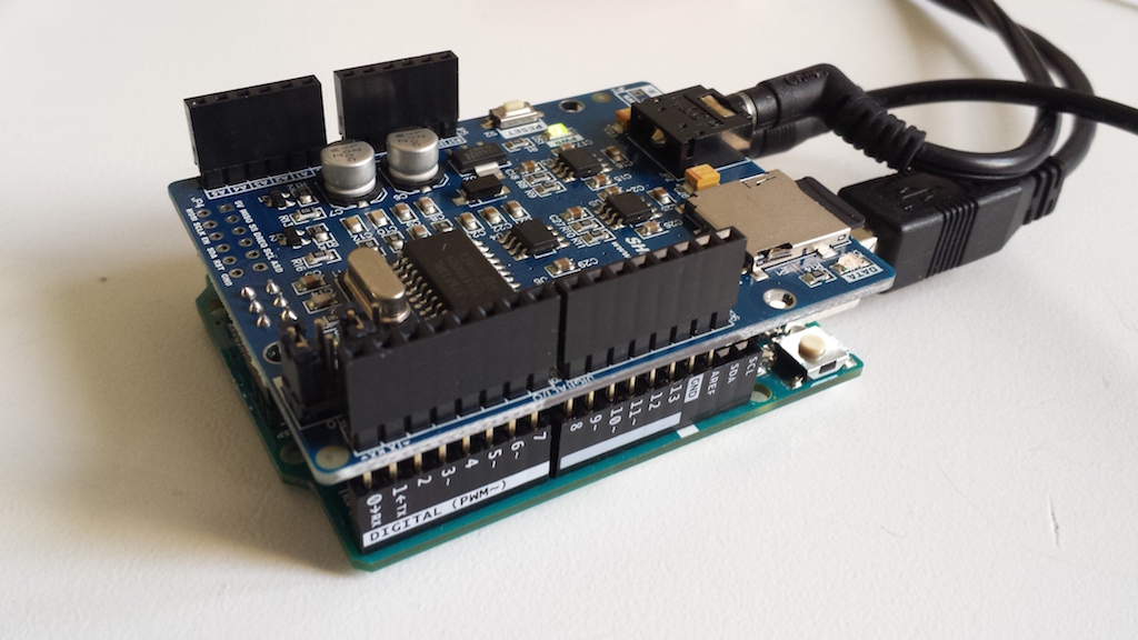

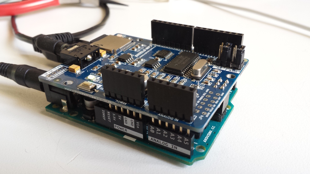

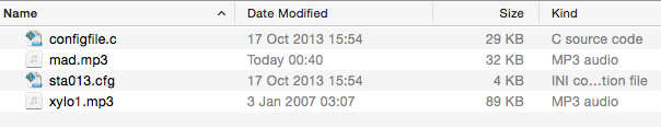

Thanks for the quick response. Indeed I didn't copy configfile.c to the SD card. I did now, but it doesn't seem to solve my problem. It is remarkable that when I select a different .mp3 file, that the pitch of the noise is different.
The set-up is pretty simple: the mp3 shield on top of the Arduino Uno. A USB cable to my Mac, a powercable to the adapter and the headphones.
I attach 2 pictures of my set-up, the contents of the SD card, and the output window:

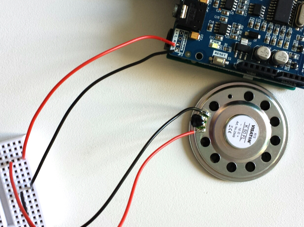

First I tested a 16ohm speaker on my phone to make sure the speaker was OK. It was. Then I attached the 16ohm speaker to the R output of the shield. It produced the same humming noise as I had before.

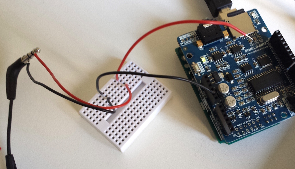

Then I soldered 2 wires to a headphone: the black to the sleeve, the red to the tip. I tested again to make sure the connection and headphones works. The did. Then I attached the black wire to the GND and touched the capacitors with the other wire. I would just get a little click sound as soon as I touched the capacitors, but no other noise at all.

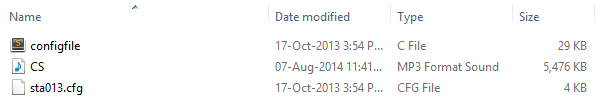

I hv different kind of problem with my cytron mp3 shield (refer the image). Im using mega 2560. I hv read and tried the recommendation in this topic but unsuccesfull.
