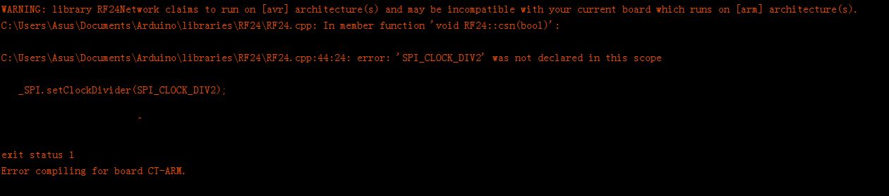

I am currently working on a project to interface nRF24L01 with Cytron ARM Cortex M0. I knew that nRF24L01 will be compatible with this board, however, in terms of the library I am using (RF24 and RF24Network), there is no support for Cytron ARM board. You can refer to the attachment on the error message.
May I know if there is a workaround for this problem or how should I modify the library to enable this support? Any links to understand how to modify Arduino library for new board support would be helpful too.

You can go to RF24.cpp file and replace
      _SPI.setClockDivider(SPI_CLOCK_DIV2);
with
#ifndef __NUC131__
#endif
This is just a temporarily fix for compilation. I have just checked the RF24 source code, the minimum SPI clock rate is same as the SPI clock rate set by CT-ARM SPI library. So in this case setClockDivider is not really needed. However, you still need to test the performance. With SPI_CLOCK_DIV2 settings, clock rate is double the default one.
