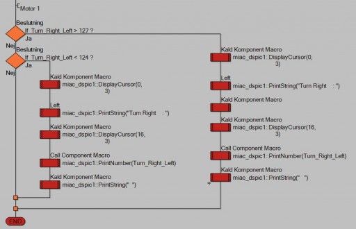

Postby sun » Sat Jun 17, 2017 10:25 pm
LawnMower Wheel steering!
I bought SmartDriveDuo60 MDDS60
And want to use FlowCode coder to control MDDS60.
MDDS60UsersManual:
http://www.robotshop.com/media/files/pd ... Manual.pdf
Please see here!
Page No: 2
Page No: 20
There are different Input Mothes
Analog/PWM Input Mode - Page No: 18
Simplified Serial Mode - Page No: 21
Packetized Serial Mode - Page No: 23
Is there anyone here that will help me get an output to MDDS60 from
FlowCode, which is attached here!
MIACdsPIC-LawnMower-022.zip
(4.31 KiB) Downloaded 451 times
Code image:
Yours sincerely
Monie
