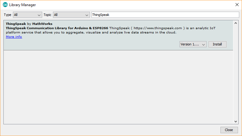

I tried to compile WiFiThingSpeak example from Cytron ESPWiFi Shield. But the compilation is terminated.
Error message displayed:
C:\Users\gorugomu\Documents\Arduino\libraries\CytronWiFiShield-master\examples\WiFiThingSpeak\WiFiThingSpeak.ino:4:24: fatal error: ThingSpeak.h: No such file or directory
Where I can get ThingSpeak.h header file since there no such file in the CytronWiFiShield-master folder?
Thank you

Hi gorgom,
I just search "ThingSpeak" in Arduino Library Manager (Sketch - Include Library - Manage Libraries...) and found this. You can try to install and compile again.
ThingSpeak Arduino Library.png (10.11 KiB) Viewed 3455 times
