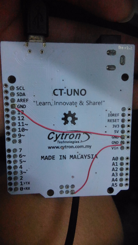

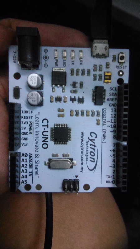

Hi guys, I'm facing an issue with my current Cytron Uno. It's been quite some time (few months) and right now it happens that the code (even the simplest 1 output constant HIGH) was unable to perform.
The code can successfully uploaded into the board. However, the LED I used to try it on that particular pin that I'd programmed it to be ON do not turn on. Picture of my CT-Uno is as shown.
Was wondering is it possible that I send it over for a repair or any alternative to solve this issue?

For the 2nd photo, any reason why there have a few jumpers connecting the GND pins?
That is the previous repair help and done by Cytron. I accidentally short a 24V into my device during that time. After the repair it seems to be working fine up until now.
