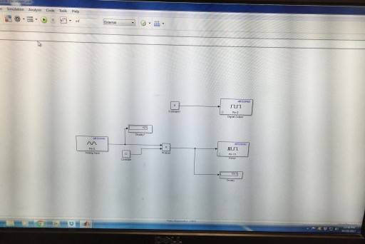

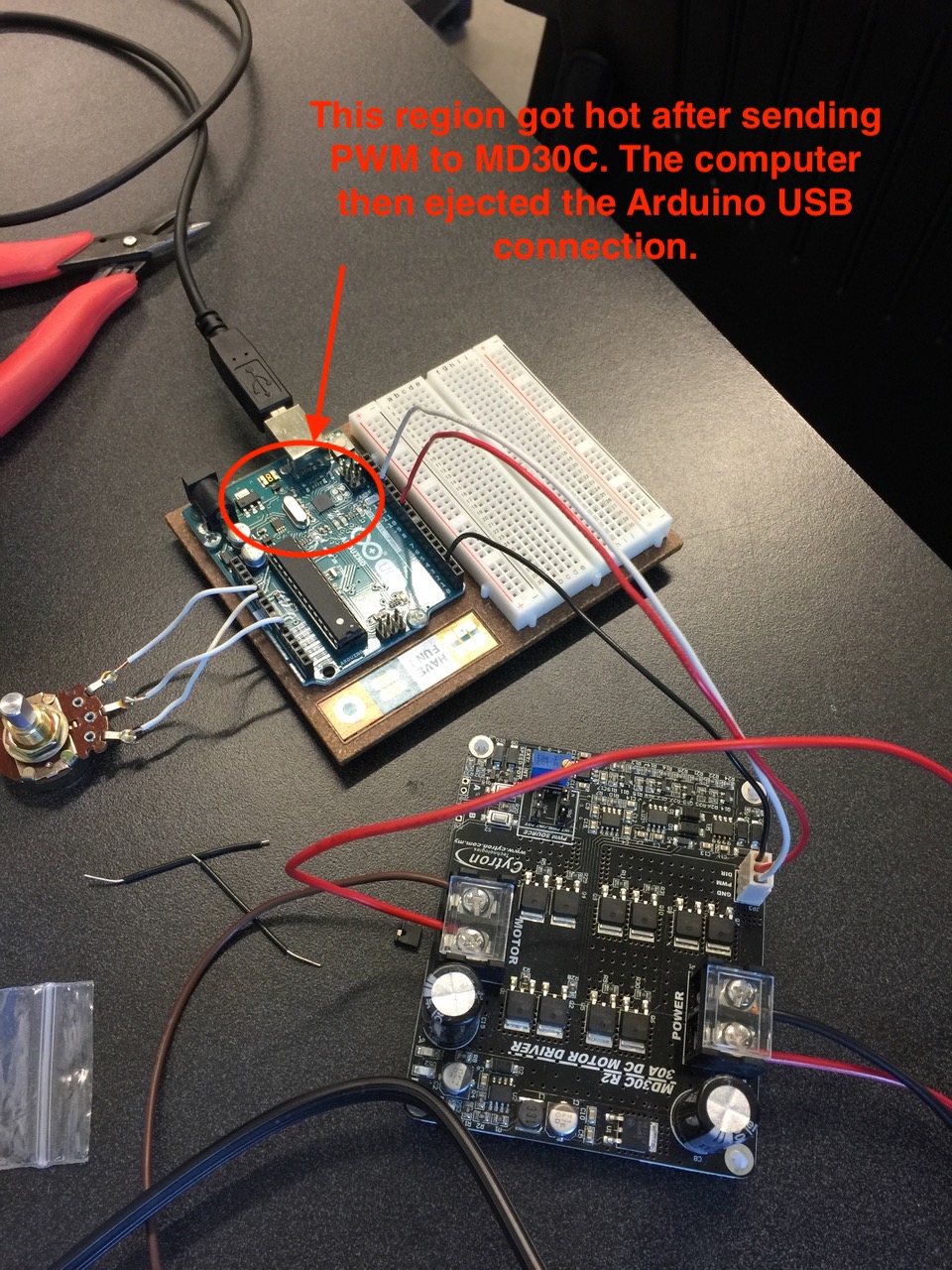

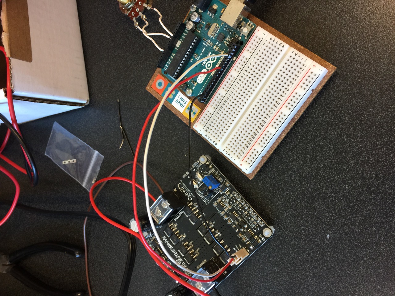

I connected the MD30C to the Arduino uno as shown in the pictures. I am controlling the Arduino via Matlab Simulink (see pic). As soon as I try sending a 5V PWM to the MD30C Simulink flashed an error saying the connection with the Arduino was lost and the computer made a chiming noise as it disconnected and reconnected with the Arduino via the USB. I tried this twice, the second time I tried it the Arduino got hot and stopped working. Now when I connect the Arduino only 1 light comes on and it gets really hot. It wont connect with Simulink any more. I'm not sure what to do. Any ideas???

Thanks for clear photos and explanation, helps a lot.
The connection seem to be correct. What is the power source you are using to power the motor driver? Mind sharing the power source? Please do not use Switching Power Supply only, if you need switching power supply, please parallel it with a battery (same voltage) to absorb the flyback current generated by motor when it slow down (or in become generator).

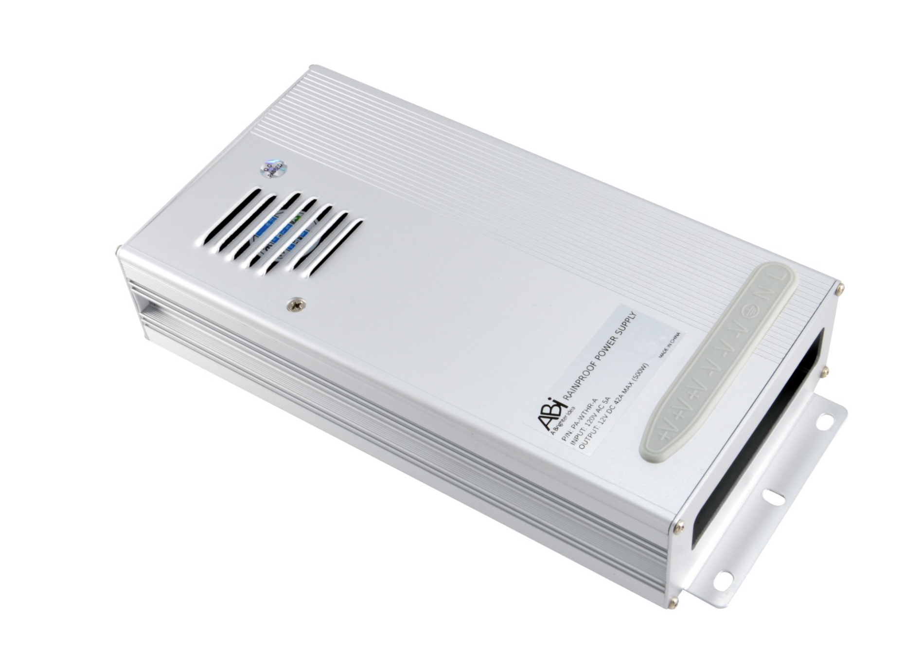

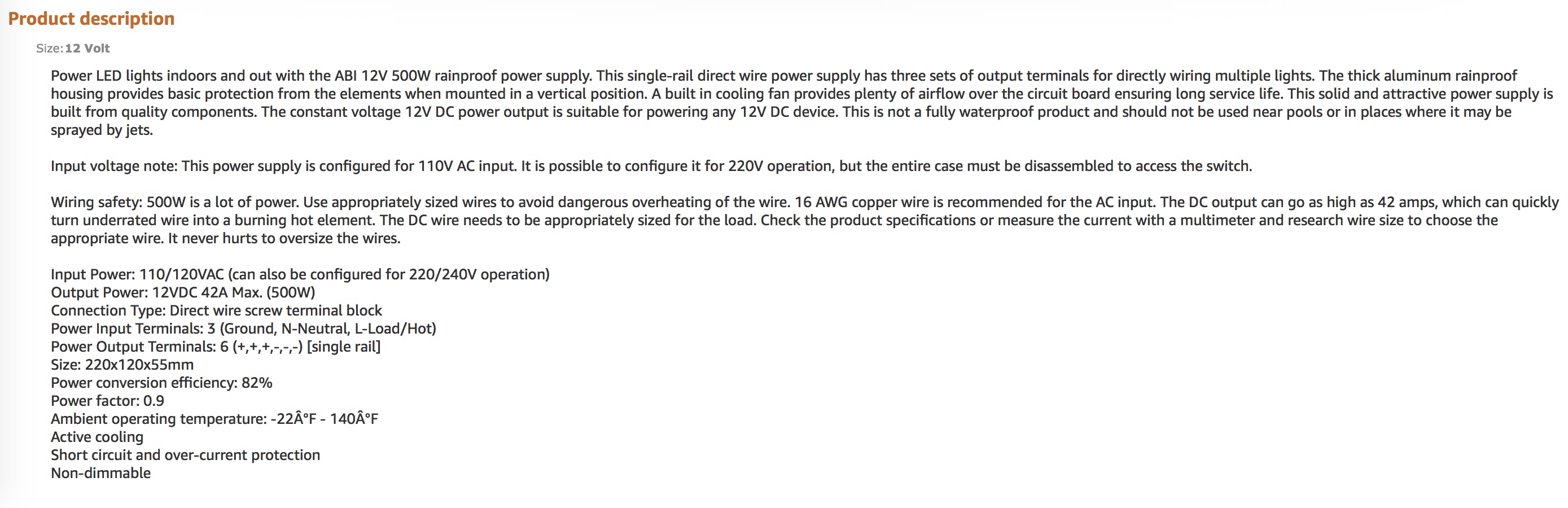

Postby zachreinke » Fri Oct 20, 2017 5:57 pm
here is the power supply we are using.

Thanks for clear photos and the power supply description and spec.
I do not see any error on the connections and setup except we do not recommend switching power supply as the only power source as stated earlier, a parallel battery with same voltage is needed. Since the is no motor being attached and the MD30C does not take power from the control signal (PWM, DIR and GND), I do not think is the MD30C problem.
Currently the Arduino is damaged right? There is no description on MD30C, you can actually tried it out with the on board manual button and on board potentiometer. Even without signal from Arduino, standalone; just the power supply is sufficient.
