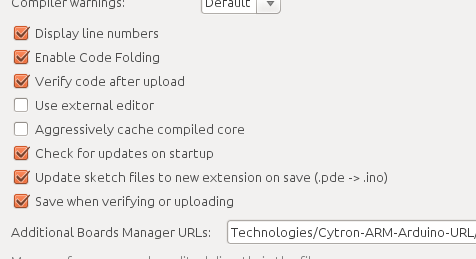

Postby bengchet » Tue Jan 02, 2018 10:40 am
Just go to File -> Preferences and disable 'Agressively cached compiled core'. Should be able to solve this issue.

Postby JayJoe » Tue Jan 02, 2018 10:57 am
Hi bengchet, thanks for your reply.
I have disabled the aggresively cache compiled core, but still I am getting the error :(

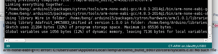

Postby bengchet » Tue Jan 02, 2018 6:21 pm
I took a look. Extract .h file from zip file attached to library folder, and remove the line #include <Adafruit_sensor.h> in your sketch.
Below is my compile result from example sketch magsensor.
Doesn't guarantee it works :) , you can share your result here after done the modification.

Re: I am getting error on CT-ARM. Please help.
Postby JayJoe » Wed Jan 03, 2018 12:28 pm
Problem solved ! Thanks so much to you. You are awesome :D
Anyway, I roughly read through the changes you have made. I noticed that you combined Adafruit_Sensor.h into Adafruit_HMC5883_U.h and then remove
#ifdef __AVR_ATtiny85__
#include "TinyWireM.h"
#define Wire TinyWireM
May I know Is it these lines are causing the problem? And what makes you think that it will works by combining both the .h files?
