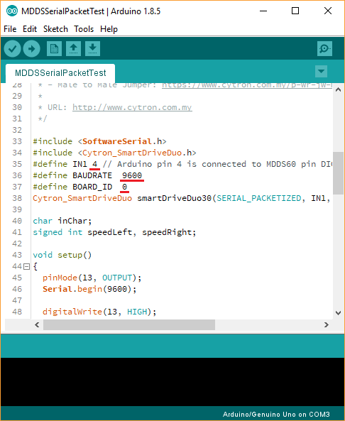

For Serial Packetized, on hardware/driver side, you need to set the DIP switch as stated in MDDS30 User's Manual page 19 under section 8.4 Serial Packetized. For example 11100000, you can refer to page 20. Then connect
MDDS30 IN4 - Arduino pin 4
MDDS30 GND - Arduino GND
If you want power direct from MDDS30 to Arduino, connect
MDDS30 5V - Arduino 5V

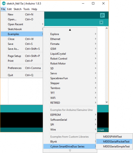

Then, at software side, you need to download MDDS30 library from GitHub link - https://github.com/CytronTechnologies/Cytron_SmartDriveDuo as a ZIP file, and install to Arduino IDE. You can refer to https://www.arduino.cc/en/Guide/Libraries on how to install Arduino libraries (Importing a .zip Library).
Open MDDS30 example code - MDDSSerialPacketTest
And upload to the Arduino Uno.
How this example works? You can read on the comment provided (at top) in this example. Try to understand how it works, then slowly add 4 switch and 1 potentiometer code to control your motor.
I hope this explanation helps.
