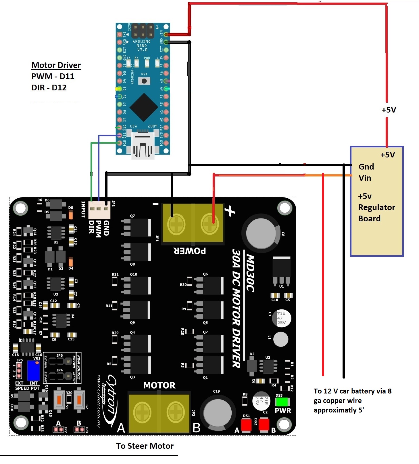

Postby jkhofer » Thu Apr 26, 2018 9:08 pm
Ober thanks for the reply, I don't have access to the circuit right now but will take some pictures once I do. I have attached the basic circuit diagram minus the other connections to the arduino.
Even when the PWM is commanded to 0 or the PWM pin grounded the motor will turn very slowly in one direction. Measuring the voltage across the Motor A and B terminals I get about 0.4 to 0.6 V when only the MD30C is powered up or PWM is 0. Once PWM is commanded the motor will turn both directions at the various speeds but when PWM is 0 the motor still moves in one direction (very slowly). I do not hear the PWM wine of the motor so i don't believe it is PWM issue.
One thing i cannot verify is the jumper settings. Is it possible to get this issue if I didn't set the jumpers correctly?
Thanks,
Jason

Postby ober » Sat Apr 28, 2018 3:21 pm
Hi, thanks for the diagram, but a few actual hardware setup photos will be better.
The easiest way to know whether is driver issue or not, is to disconnect the Arduino from MD30C. Just connect power, MD30C and motor. What is the output? It should not move as there is no input at all, even the jumpers are configured wrong.
And yes, it might be jumpers problem and that is the reason why we asked for actual hardware setup photos when it comes to troubleshooting.
