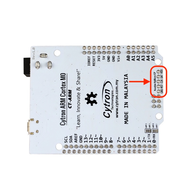

You can direct program to CT-ARM through Nuvoton Numicro ICP connector.

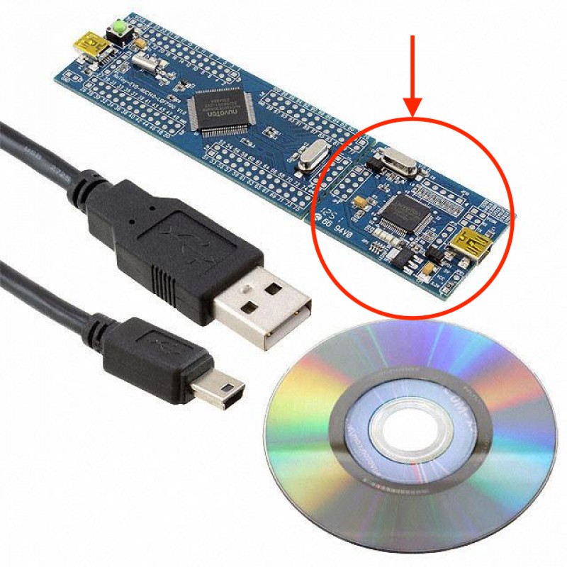

We don't have standalone Nuvoton Numicro ICP. However, you still able to get it at NuTiny ARM Cortex-M0 Starter Kit.
