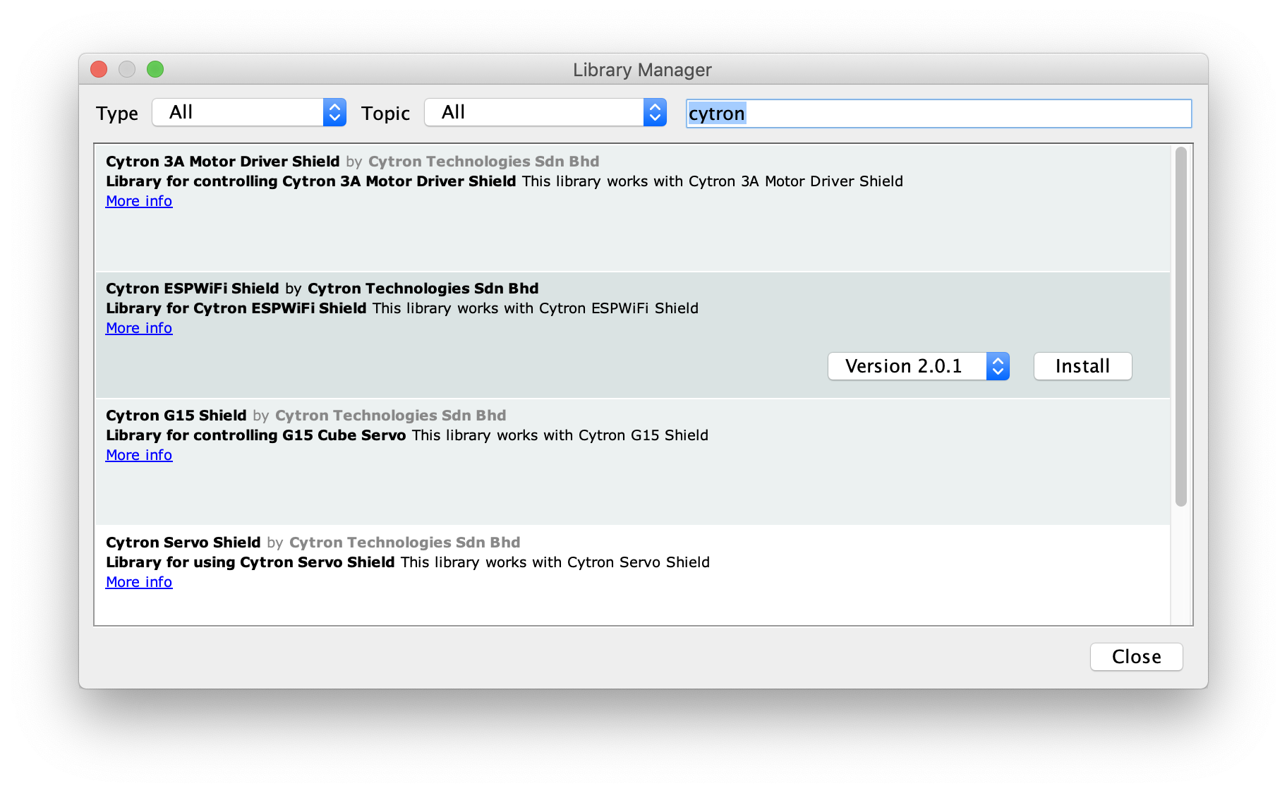

Hi hermaans,
Could you try to download from Arduino Library Manager?

Thanks. I did all that and it is now running stable. I checked for almost 3 weeks now and the Blynk application runs without a single restart. I just ordered 2 more to replace hardwired connections.
