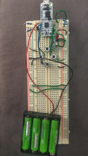

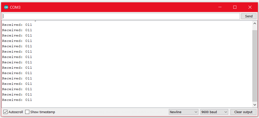

Hi, I am trying to use my cuteduino to be a remote control for my robot via 433MHz transmitter and receiver. I attached pull-down resistor button to pin 1,2,3 and 4. pin 0 is used for the transmitter. I tested it and realise that the pin 3 button keep transmitting its message as if its pressed on. i tried pressing pin 4 button but nothing worked. pin 1 and 2 buttons is working normally. After doing a bit of research, I realise the issue could have been that pin 3 and 4 is used for USB comm. So i replaced my power supply from USB to battery but the issue remain. Could I know how to allow pin 3 and pin 4 be used a normal digital pin?
The arrangement of button
The serial monitor readings

Hi , sorry I just found the solution for it.
It's from this link.
https://www.reddit.com/r/arduino/comments/28tjjz/need_some_help_with_digitalread_on_pin3_of/
Apparently there is a pull-up resistor in pin 3 and i just need to rewire it to be a pull up button and change my code.
