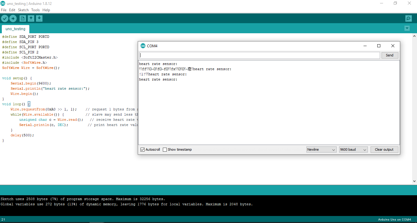

Hi, I am working on a project that requires me to get the heart rate readings from the sensor but unfortunately I failed to get it. I have no clues whats wrong.
basically, i follow the tutorial fromhttps://www.youtube.com/watch?v=Dzq4tnJ0LjA. Instead of using maker uno, i utilise the arduino uno r3 but i failed to get the reading. Anyone can help with this? I will appreciate it and thank you.
The serial monitor just showed nothing :(
serial monitor reading

Hi,
Can you test again using code from this link?
https://wiki.seeedstudio.com/Grove-Fing ... ith_shell/
Try using Hardware I2C and not software I2C.
