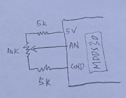

You can do that by connecting a resistor in series with the POT at 5V and GND each like this:

Waiweng83, your idea with the resistors did not work out. the idea was great, maybe there is another way to solve the problem.
at this moment the y axis runs the left motor cw and ccw and the X axis runs the right motor cw and ccw.
if I want both motors running forward, I have to have the joystick moved 45 Defr. either side for cw and ccw.
