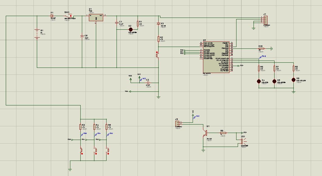

That's becos your buzzer is connected at the wrong place.

At the wrong place? That's weird. I'm sure 1 pin is connected that the VCC and the other is connected to the 1k resistor.

Your last schematic
According to your schematic, if you move your buzzer from RCx to J3 then it would function correctly.
