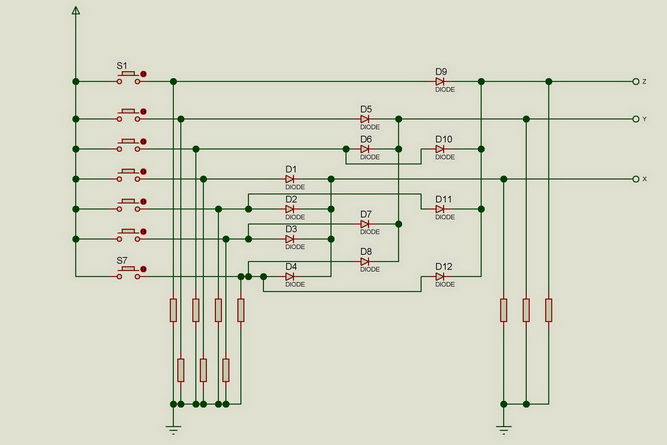

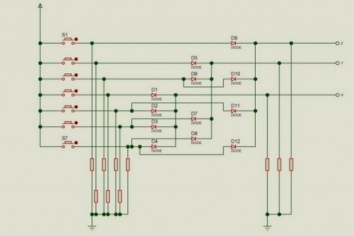

Postby ABSF » Thu May 17, 2012 6:40 am
A decoder 74138 would do the opposite of what you wanted. So what you're looking is an encoder...
There are BCD to 7-segment, binary to BCD encoder but never heard of an 1 of 6 to BCD encoder. I'am afraid you'd have to construct your own using discrete TTL or CMOS gates. Something like this.
Let's call the 3 outputs x,y,z and the 7 switches s1 to s7.
x is high when s4-s7 is high
y is high when s2,s3,s6,s7 is high
z is high when s1,s3,s5,s7 is high.
This example uses diodes and resistors. You can use multi-inputs and, or, nor, nand to do it if you want

Postby radians » Thu May 17, 2012 11:44 am
thanks buddy!..it gives what i want.cool. but its seems need 12diodes and 10resistor and it make my cct bigger. is it any IC that i can use?? u just said can use gate. but how to do that??

Postby ABSF » Thu May 17, 2012 12:46 pm
I gave you an example! The rest should be left as an exercise for you and your group. :mrgreen:
