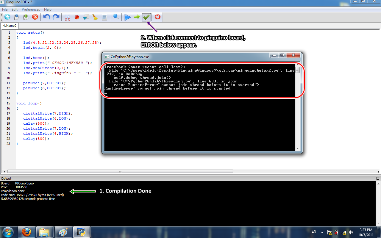

For pinguinobetax2.py
From the picture, compilation is done, but when I click to connect to Pinguino board, ERROR happen. Then when I continue with upload to the board, it display done but nothing happen at the hardware.

Hi ! Thanks for supporting Pinguino and sharing your problems! :D From the image you attached, I just realized that you click the "tick" icon, not the "arrow" icon. To upload the program into the board, click the "arrow" icon. I also got the same error with that "tick" button but just ignore it...you still can upload the program using the "arrow" icon..I also not sure what you mean by "it display done". However, if you success, there will be a message "xxx.hex successfully uploaded !!" shown in the IDE output.

Postby shahrul » Thu Oct 27, 2011 12:35 am
Why the code size is big? 64% used, it's only LCD program.

Postby twk1989 » Thu Oct 27, 2011 12:41 am
@ shahrul
Hi ! I guess the size is probably because of the LCD library from ...\Pinguino\x.2\x.2\p8\libraries\lcdlib.c :D
