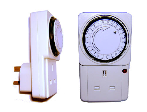

Postby ABSF » Fri Dec 02, 2011 3:16 pm
How are you going to power your circuit? If you are powering your circuit using an AC adaptor, there is a power socket with timer That you can buy. The timer can be digital with a small keypad and LCD. The analog one comes with a wheel with teeth where you can push or pull them in or out to ON or OFF the timer. Each tooth represents 15 minutes. Just plug your adaptor on top of the timer and set the ON and OFF time.

I did plan to just connect it to adapter - which is stick to the old circuit and make it manually on and off. But I think it's not really that practical. Could you explain more about the teeth-adaptor thing?

Postby ABSF » Fri Dec 02, 2011 11:47 pm
This is how it looks like
This is the digital version
