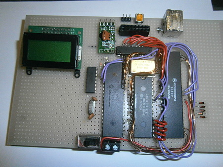

What I have in working condition is a RAM bootloader based on PIC16F884, 128K RAM, fully works! To do away with the EPROMs.
The best prototype so far:
However no schematics exist for that.

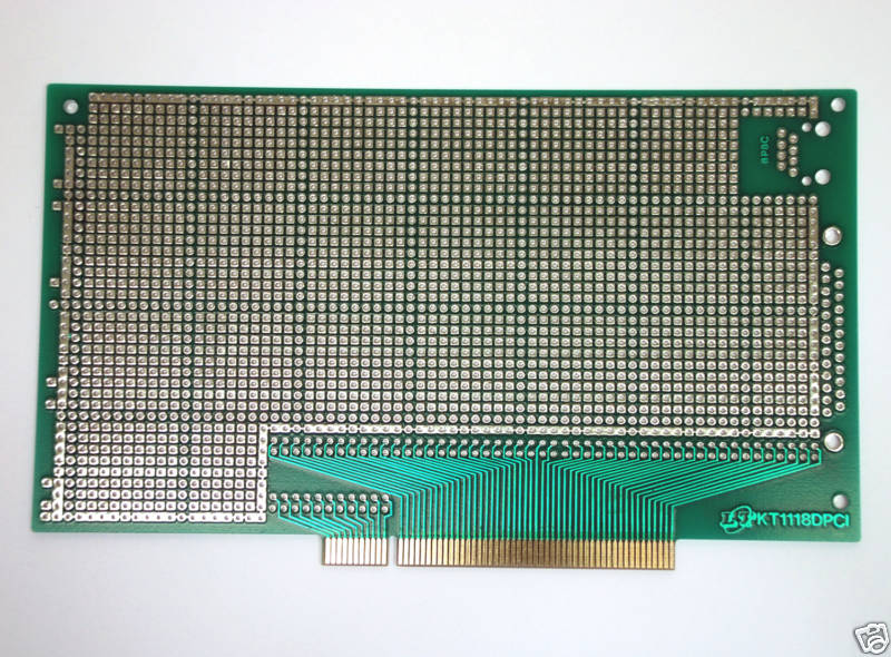

Here the PCI PCBs that go into the PCI backplane:
These should be here in the next few days.

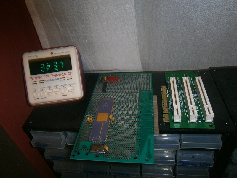

Postby takao21203 » Fri Jun 01, 2012 6:26 pm
OK here an update, PCI backplane + one card together with 68000 chip.
I will work on this project if I find some time.

Postby Brian Griffin » Fri Jun 01, 2012 7:28 pm
Hmm. Cool. The huge chip is such rare stuff.
Btw, what's that thing that is on the box with the 7-seg display? It said "Elektronika 01" and "Kvazar". (Pardon my limited Russian - I only learn the alphabets from my neighbor who studied in Moscow before...) :)

Postby takao21203 » Sat Jun 02, 2012 8:03 am
yes CERDIP is not manufactured anymore since the late 1980s at least not for consumer chips.
these are from 1985 still have 20 or 30 of around here.
They actually figured out failure rates for manufacturing are higher for CERDIP than for plastic,
so it was not prefered anymore to use.
The gadget on the left is a VFD clock from Ukraine, bought this from eBay, when I saw it on a soviet vintage electronics website. This one was developed in the mid 1990s. And it's quite obscure, has a reset button, after power up does not start up correctly. A switch to stop/hold time as well, and to change between hours/minutes, or minutes/seconds.
