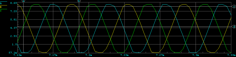

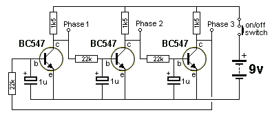

i'm doing simple 3 phase sine generator by using phase shifter method, but i having on problem on these situation :
1)cannot generate sine wave output(hardware) on oscilloscope(i got straight line output voltage,and miss 1 phase voltage output) as produced by the simulation software i used (Multisim 10.1), please take a look on the below picture.
2)any idea the indicator for this project,i run out of idea..because the output voltage for this project is very low(the max i could get about 3v-4v), please take a look on the circuit at the below picture
Please do not hesitate to comment and give your suggestion on this project, because i'll really appreciate it and i need to improve the project.
This actually i took from internet but just like my output in the multisim
The circuit i took from talkingelectronics.com

I'll build the same circuit according to this and test it if I'm free this weekend - I have an oscilloscope at my side. I have to get the 1uF caps and the 22k resistors first, they got ran out. :)

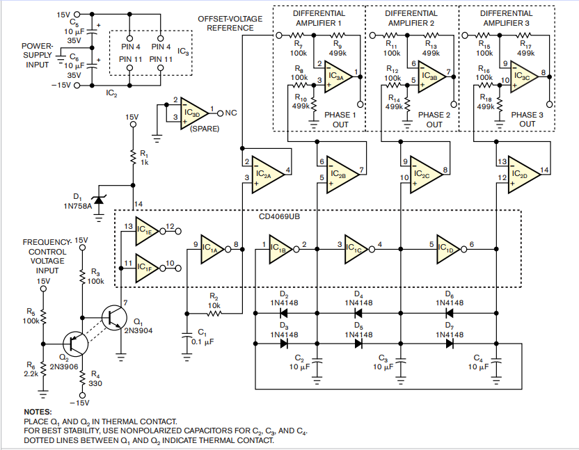

I've something to ask,do the circuit is too simple and should i consider to use other circuits such as the picture below.
(1st circuit i took from here http://www.edn.com/design/analog/431832 ... d-outputs#)
(2nd circuit i took from allaboutcircuit from, and the author said the output of the circuit couldnt be more than 10k impedance else the circuit wont work if the impedance exceed 10k)
i wish to put indicator(hardware) on the output so the project could be much more attractive rather than showing on oscilloscope only..
Please do not hesitate to comment more..and thanks in the advance.
Hello,
Unfortunately I did not study much on analog or power electronics - only one basic semester back then since I did not major in E&E. I'll offer advice as much as I can.
If the 1st circuit works well and too simple, you should have chosen the 1st circuit. It's easier to fix problems compared to the 2nd one.

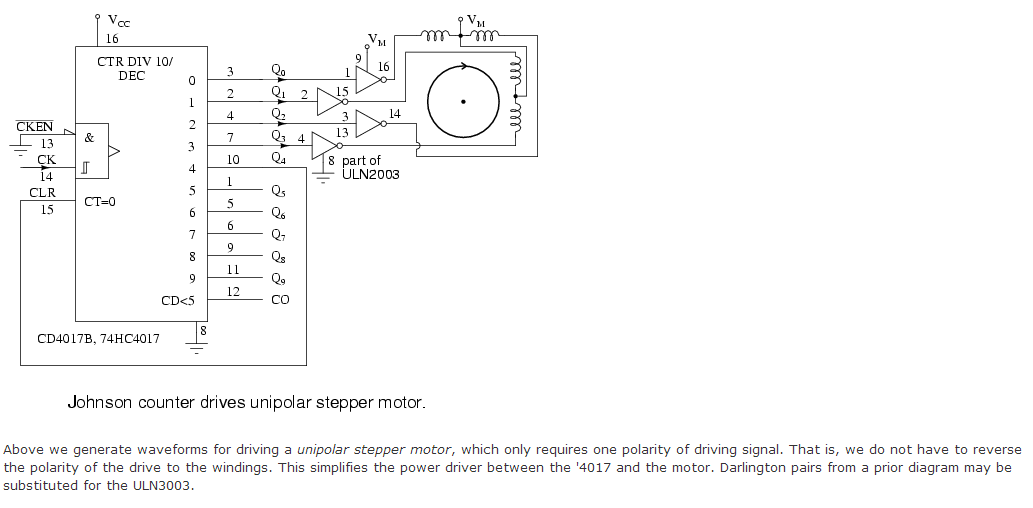

Thank you Brian for your response, its actually my Technology Electric mini project. My lecturer ask to make a 3 phase generator project, and i proposed some sort of circuit with an input directly tapped from 240 VAC supply voltage and the circuit are using expensive component such as power mosfet, so he suggested me to make simple 3 phase generator with using phase shifter method.
My subject is actually not quite much related to phase shifter(maybe in power electronic), i just wish to have a project can use hardware indicator output. What do think about this circuit as the below picture.
Really appreciate your reply,thanks.
A circuit from allaboutcircuit.com website

Postby Brian Griffin » Fri Nov 30, 2012 4:07 pm
Start from making a simple sine-oscillator first. One sine wave. There are analog circuits on these online, and you have to search it.
If you can use digital systems - I would recommend a microcontroller. You may need to use a "table lookup" for these kind of things, or other methods on sine wave generation. Here is one example, but using an induction motor.
Note: Be very careful when you deal with high voltage alternating currents. They are deadly. Observe safety rules in the lab, and wear grounding shoes if possible.
